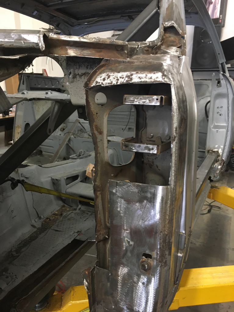

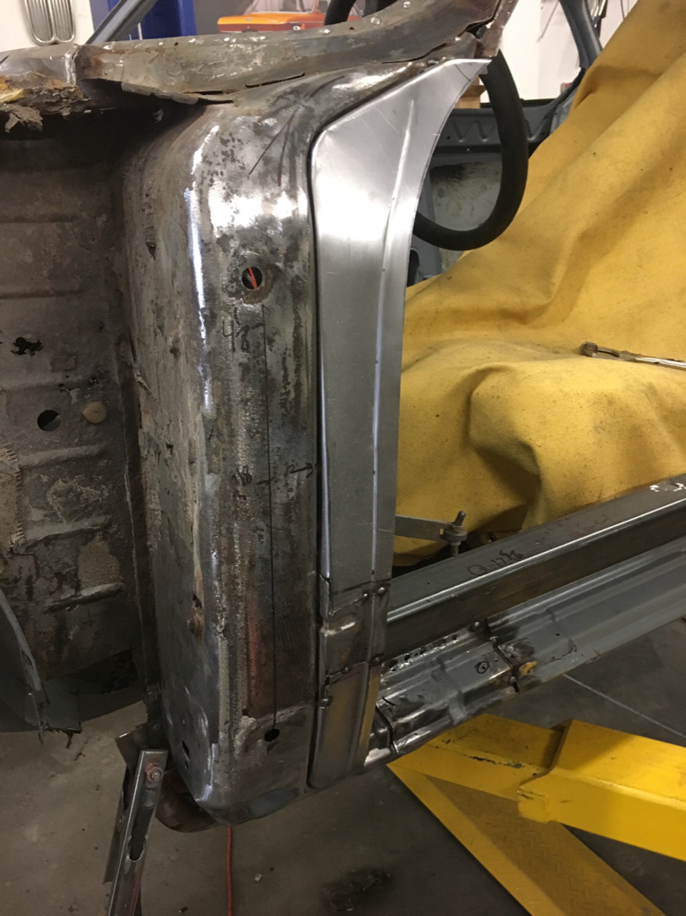

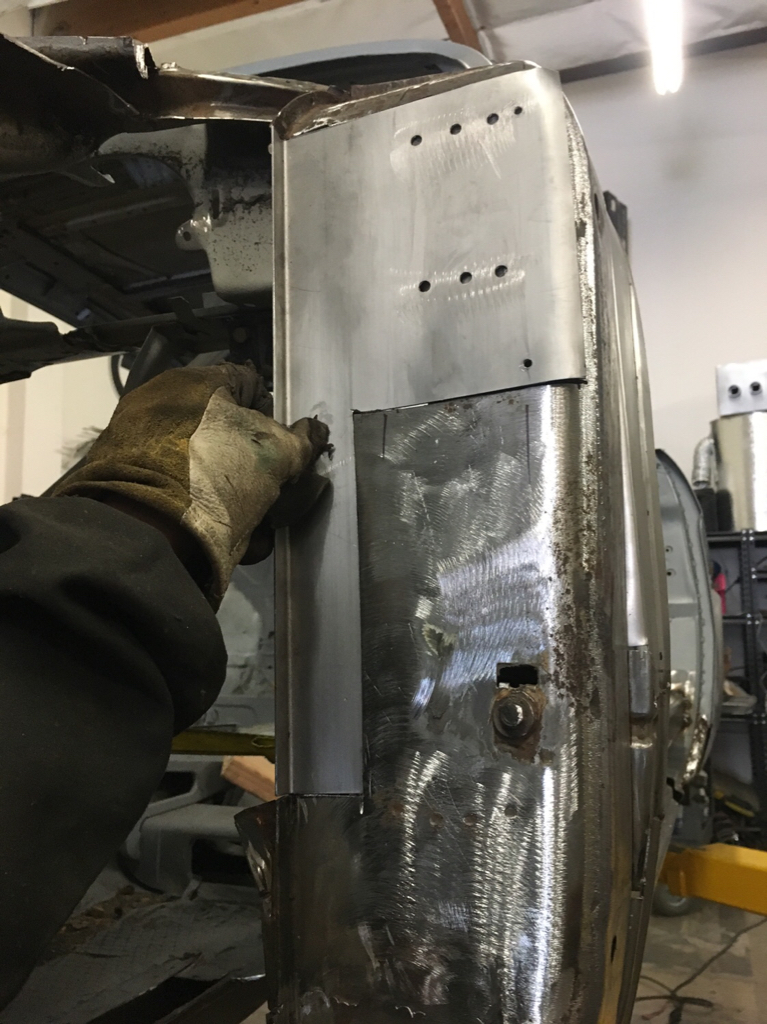

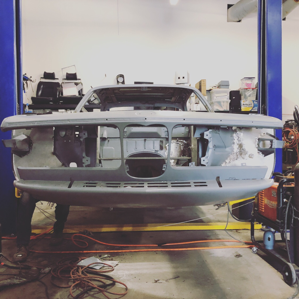

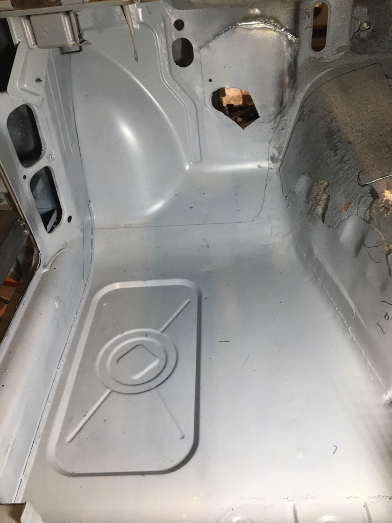

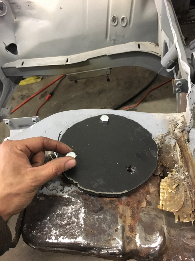

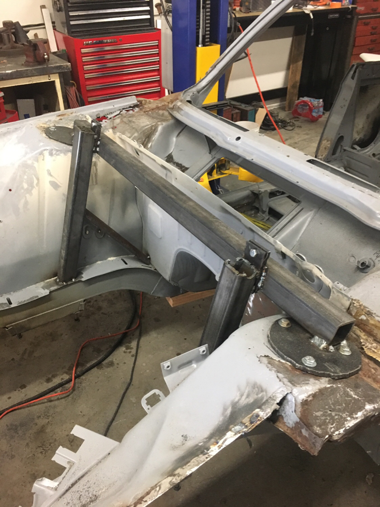

As it went, I have learned that I wouldn't trade this metalwork experience for anything. Even though Tyler is doing the heavy lifting, it is happening in my shop. I pitch in most days cutting, grinding, measuring, etc. It is so fascinating learning from a master how to restore this car. Not only am I learning more about my car, but I know exactly what it is I am driving - if I ever get that far![]()

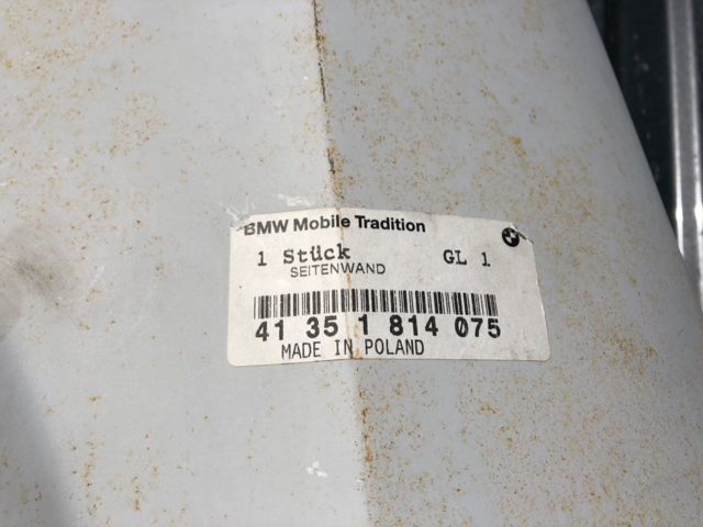

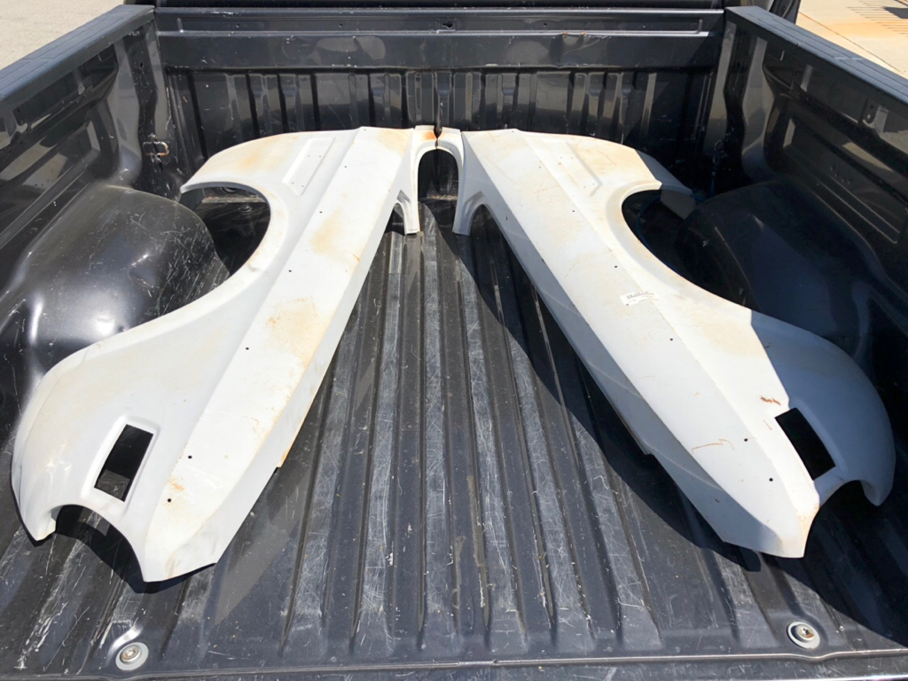

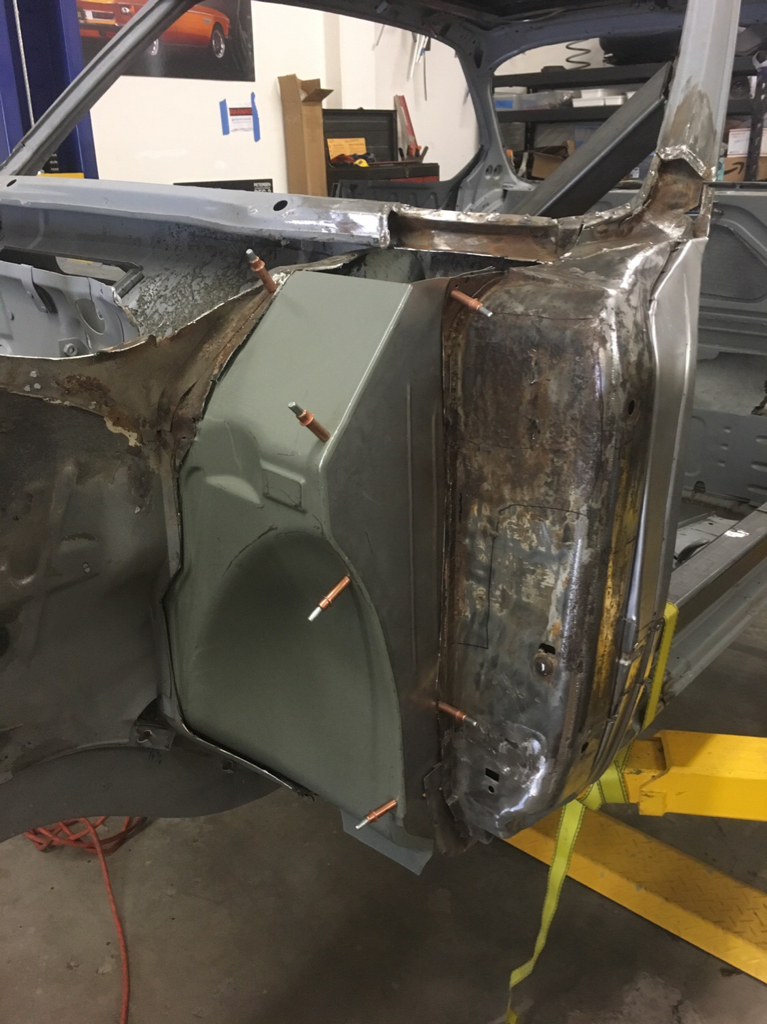

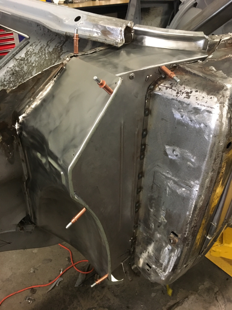

No doubt the right choice. I fear that I will come to the same realization one day (and by then the unicorn fenders will cost even more).After debating what to do about fenders I finally bit the bullet and overpaid for a new set of BMW fenders. Mine had been poorly repaired at least once and so much of the body of the fender was pitted enough that you could push a pencil through it. We would have to replace 70% of the steel which could take weeks to properly fabricate (with emphasis on “properly”)
So I overpaid for a brand-new pair that had been sitting in a warehouse for the last couple of years (hence the light rust). But they are very nice and will look lovely on the coupe later next week!

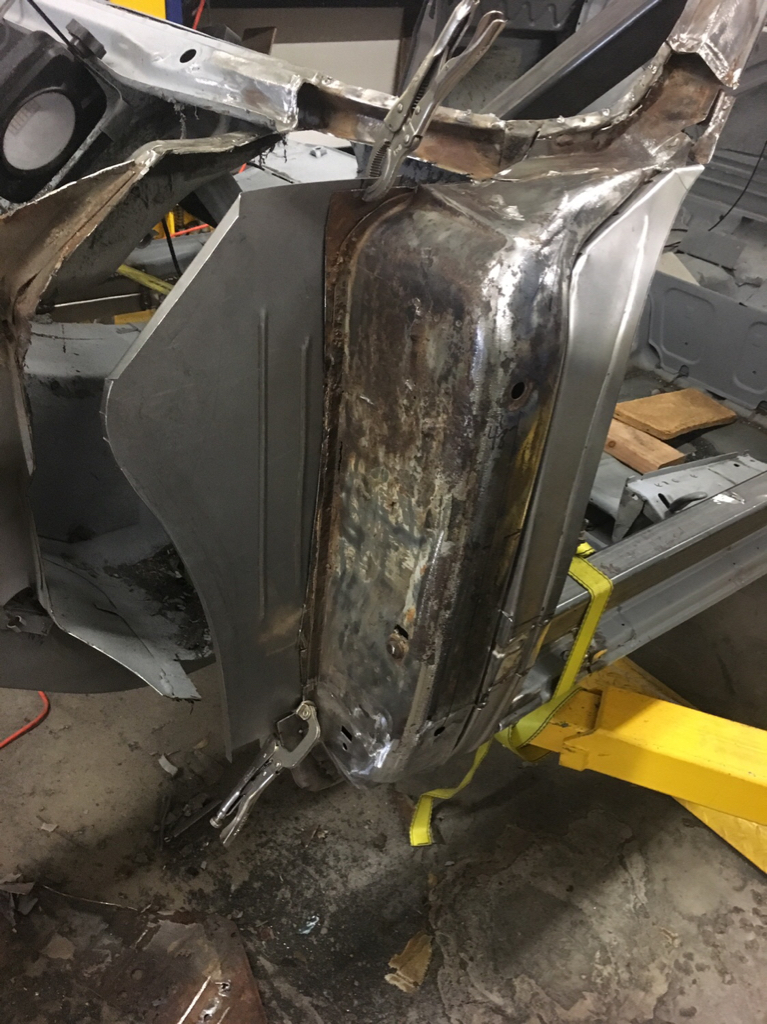

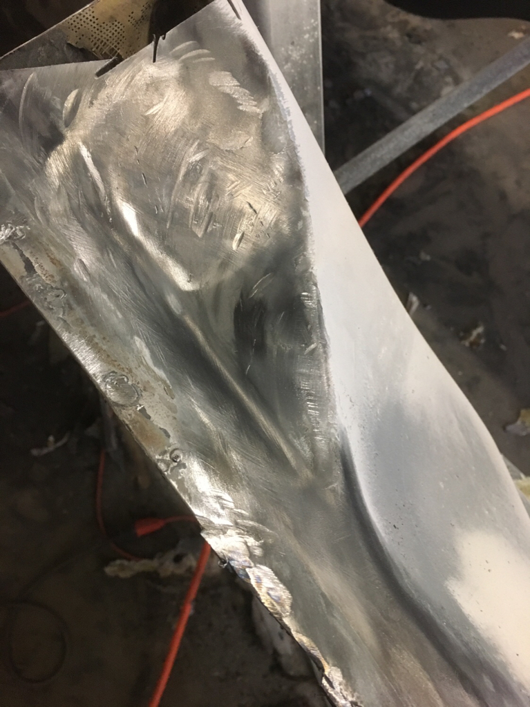

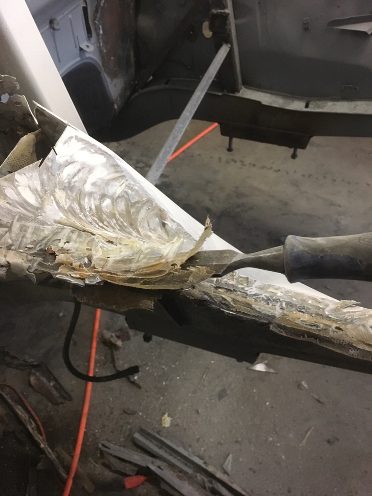

It looks like such nice clean metal under all of that - why would they do that? Keep up the good work!Starting work on the passenger side front fender. This side didn’t have all the rebar and caulking the driver’s side had, they made up for it by using a half inch thick glob of fiberglass and epoxy. It took a combination of grinders, drills and finally a chisel to get it down to clean metal.
