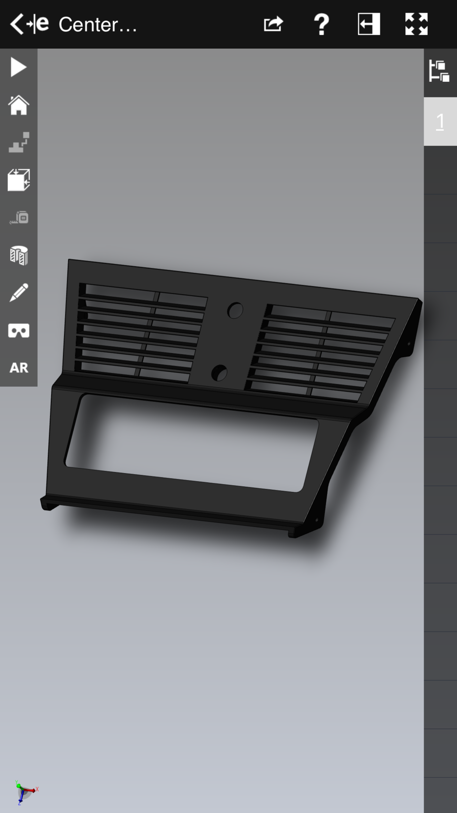

Well the printing estimates are in. Almost $500 to print with my existing method. I fell back to shapeways. Which can do an ABS print for $280. ABS will work well and stepping isn’t an issue. Very few folks will buy these. I can sell them for $350 and use the margin to recover the modeling fees if this part and others, that still need revisions.
I printed the AC duct at a 50% scale with “sandstone”, which came out to $40 plus shipping. I’ll use this to test the part.
I can also change the model to only print the critical angles and corners, with no flat portions inside. Then one could plastic weld or glue in ABS sheet.
The AC face plate has paid for itself. The margin on that goes back into the project car.

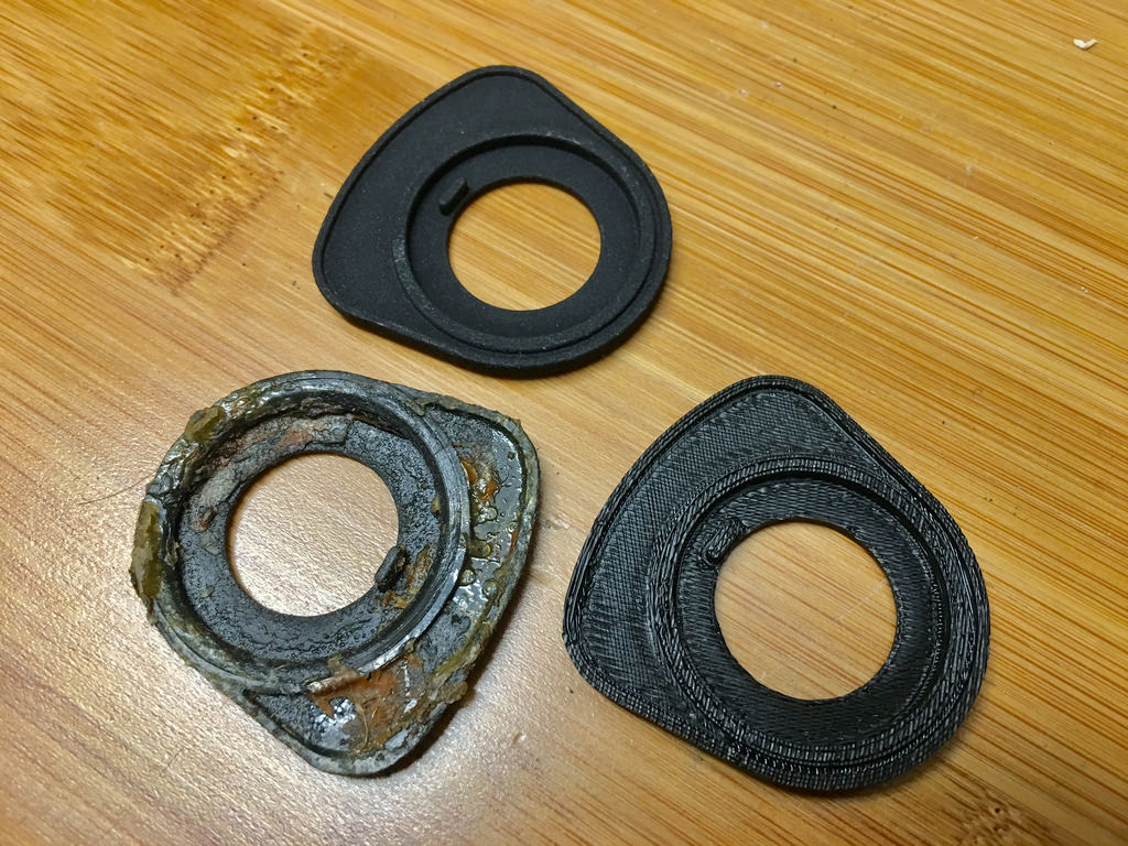

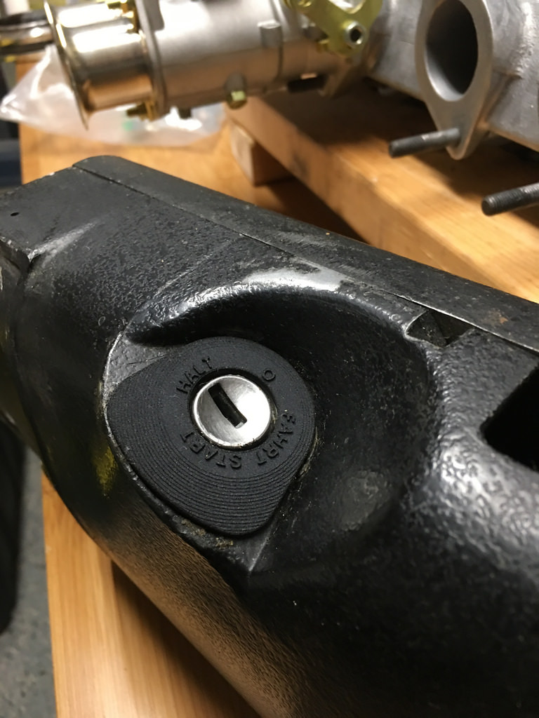

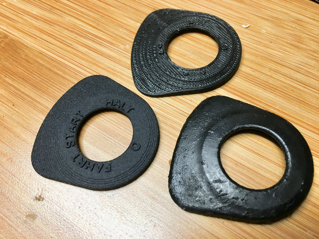

My ignition covers finally arrived.
The FDM printing in ABS was a flop (as warned by printer). I learned a bit about the vast resolution difference between FDM and SLS. I will be sticking with Vinyl and other materials for now.
The font on the Vinyl lock cover turned out well. I have some visible stepping on the cover face which is surprising. I haven’t run into that yet. I think it was because they didn’t post process the part. I will lightly sand off the stepping. I’m going to add some
more dye. The dye penetrates .25mm. Depending on how it looks I might hit it with satin paint. This area sees a lot of abuse from the key. Polished aluminum would look interesting! :D
Overall the part looks good but fits a little loose. I will need to revisit fitment. The part looks
visibly ‘off’ from the e12 cover. My modeler
has the e9 cover so I can’t compare at the moment. I don’t know about the interest in this one so I don’t want to iterate too much.
