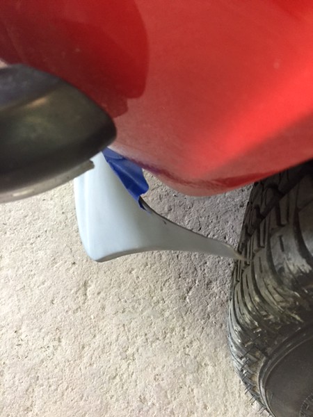

I've enjoyed watching your progress; the car has turned out great and I love the color. I'm curious about the Alpina spoiler...is it possibly from Coupeking, and if so did you have any issues with fitment of the end pieces which wrap up on the fenders? I have had one for several years but haven't gotten around to tackling it as the ends are several inches away from the fenders and there's no way to bend it that far. Peter says that it should be heated gently and then bent. Maybe I need a F'glass expert to tackle it.

Yes it is a Coupeking. Thanks for the compliments. I think I know what your issue is. They have two types of Alpina style spoilers. One, the one I have fits great, not heating required etc. The other one is from a Group 2 car that was made to fit flared fenders. It's a long story but I actually made that mistake by grabbing that one, had it painted even, tried to figure out why it was so much wider than the car even bending it etc. Then we realized we grabbed the wrong one. Just glancing at it they look similar, but one is much longer than the other and a little different shape. I will take a picture of what I am talking about later and you can compare.

Thank you for your reply. My communication was with Erik, who initially said that there might have been a mixup with what was shipped to me. After I sent the photo below, however, he told me that it was the correct piece but that it would need to be heated and then formed to the fenders. I don't have any experience with re-shaping fiberglass but a bit of on-line research would indicate that there is a finite limit to what can be achieved by heating it. In any case, I need to take it to a F'glass expert so see what can be done. This is a not-so-great photo, but accurately shows the distance each of the ends will be required to move in order to meet up with the fender(s).
BTW: I've never seen a Group 2 E3. I wonder where Peter found enough customers to make an air dam for one...

Jim, the pictures of the spoilers on their own on the garage floor look like yours to me, and those are WAY too long, I had the same problem, they are for a Group 2 fender kit. They are the wrong mold and go to fiberglass flared fenders. They look very similar unpainted sitting on a shelf next to each other. Like I said, we made same mistake, had both sets, we even painted the wrong one, the one on the garage floor. Those flare up much high just like yours. He needs to send you the one I have. The spoiler should easily follow the line down from the wheel well.
And that makes sense why they would be wider. Take a look at the other pictures of my car with the proper Alpina style spoiler. It is a mold from actual Alpina spoiler and it fit perfect, no heating the spoiler or anything should be necessary. I have a feeling they sent you the exact one that is the two pictures on the garage floor. The tail ends come up way more and it is pretty obvious like the picture from your car that they are not meant for regular E3 fenders. Hope this helps. I added a side shot and one of the latest pics on the lawn at Legends. Yyou will see the lines follow the fender lines nicely.
