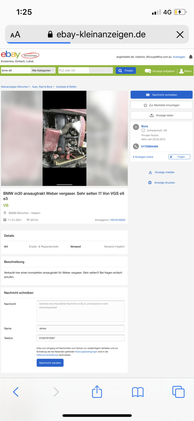

I am assuming "VB" means accepting bids?
Basically means the price is up for discussion..

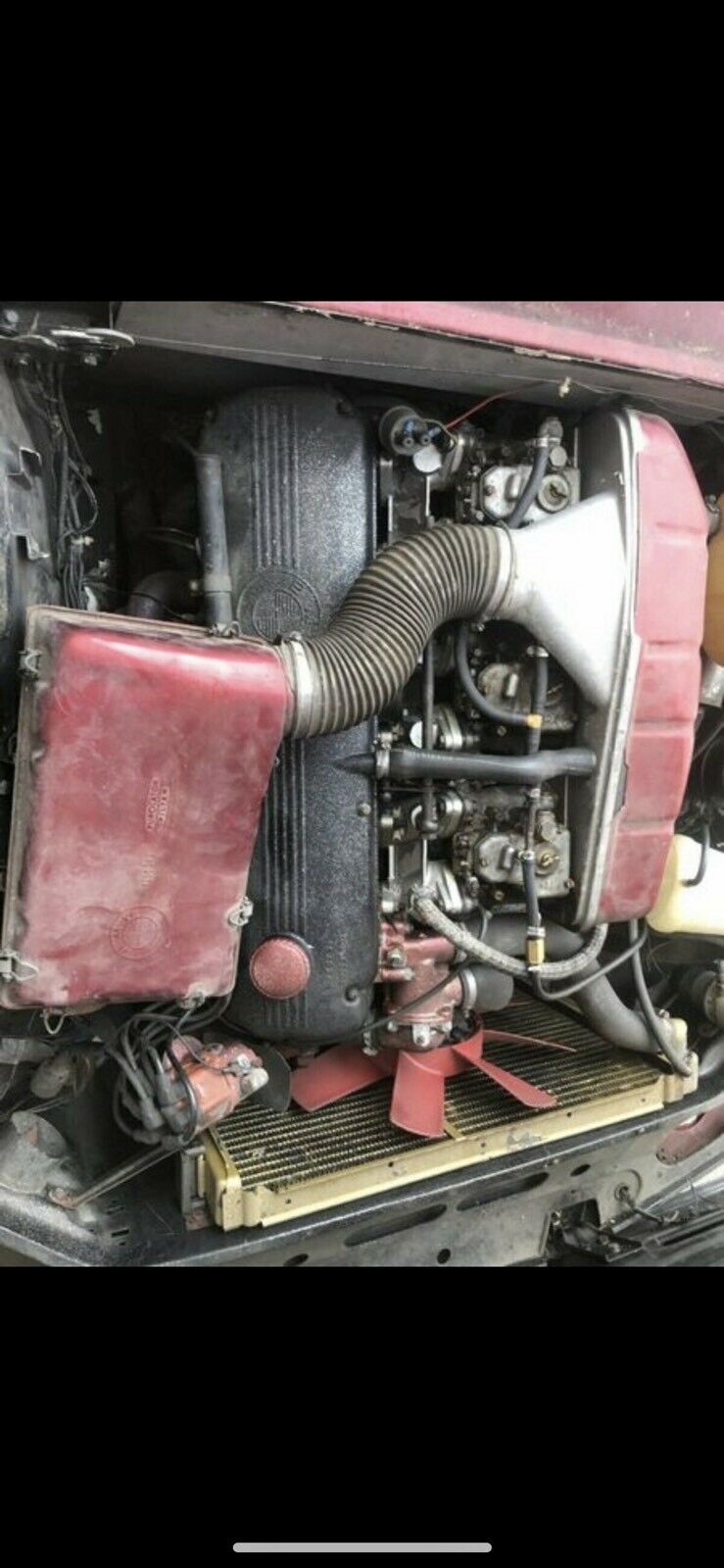

Wow. Would need close up pics, it appears that the aluminum box section groove that slots in the airbox is missing a 6 inch piece along the top side. The lower area appears to be only red paint coming off the black underneath. I wonder how much he wants and I'm assuming the manifold is included...maybe the CSi airbox?

Further down he states "
I am selling a complete intake system for Weber carburettors. Air filter, air collector and pipe. Very rare!!! If you have questions, just call. Due to the large number of interested parties, I am now putting a fixed price in here. Anyone who knows how rare the parts are. And above all what their value is.
So, he is firm on 850 euro = $1008.00 USD

The aluminum housing that attaches to the carbs has a large piece broken off the top section as seen in the pic, I am not sure if this can be repaired since it is aluminum. If it comes with the intake manifold then it might be worth it, but I am not convinced it does. I think he is referring to the red airbox, broken aluminum housing, corrugated hose, and CSi airbox, but as @Drew Gregg noted, now it seems the CSi box is not included. If that's the case, I wouldn't pay 1000 + shipping for the airbox in that condition, certainly without more close up pics.

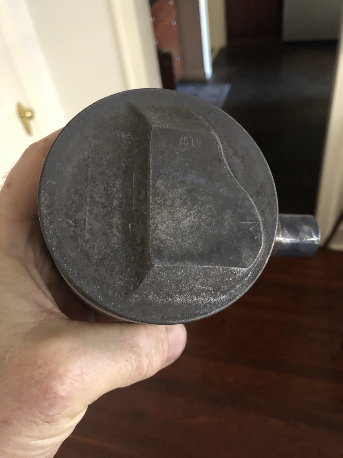

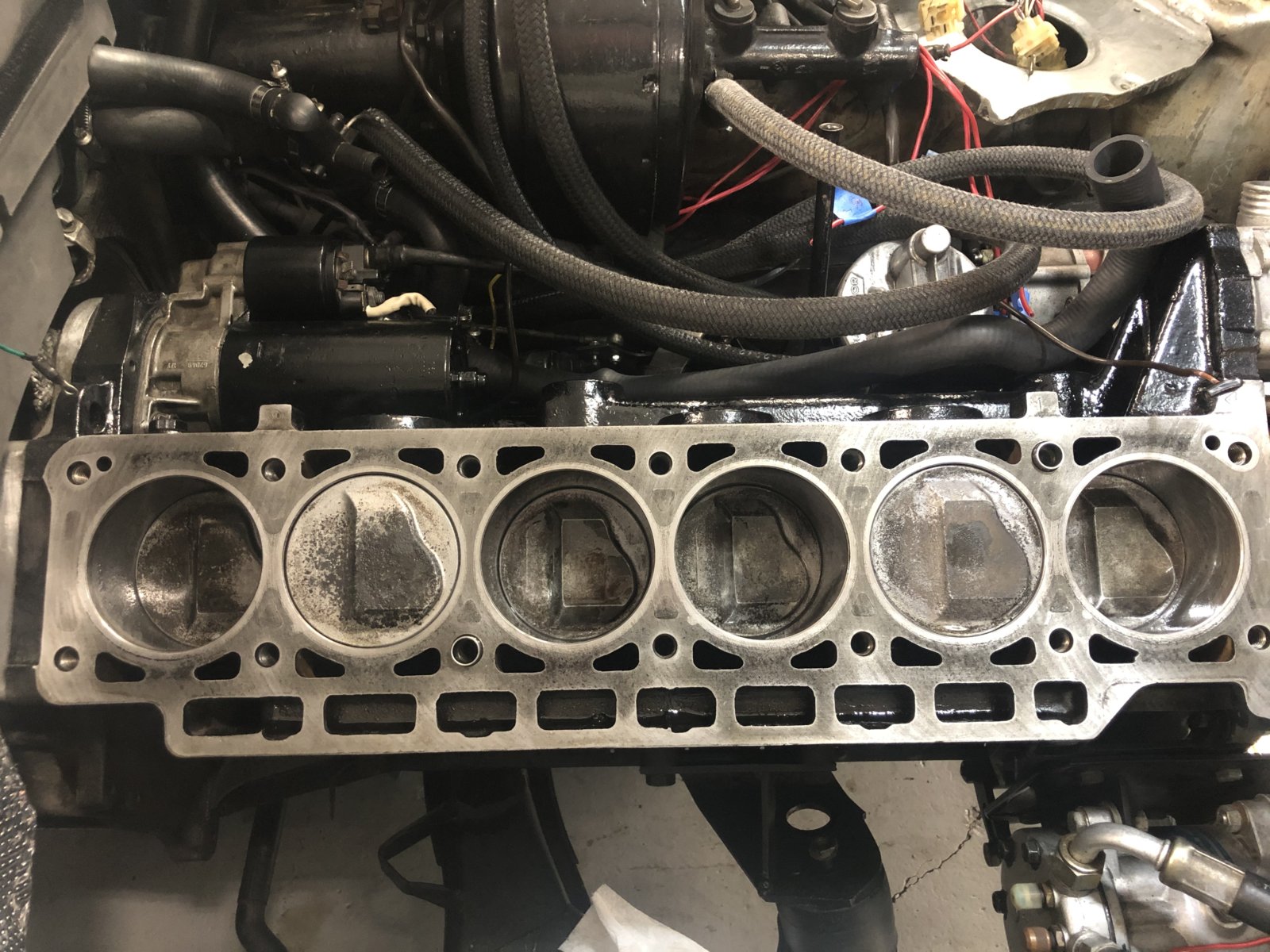

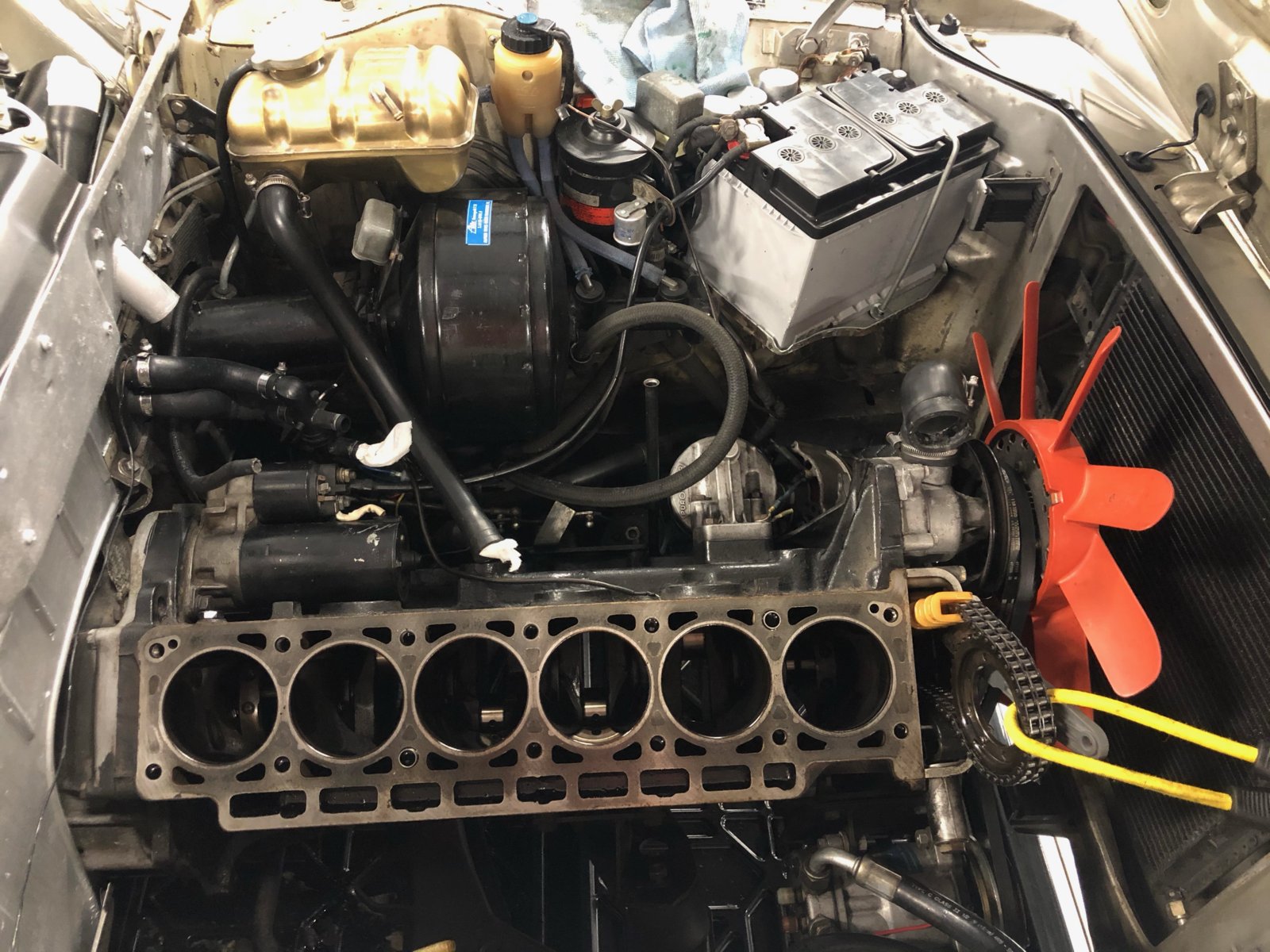

I've completed my piano top piston project to go with the VGS airbox and manifold setup, a little "go" to go with the "show". My engine has a Schrick 284 cam and triple Webers, and until now the crappy USA 8:1 pistons. For years I've wanted to put piano top high compression CSi/L pistons in. First I bought a set that were too big. Then @Wes sold me his standard size from his CSL that he is rebuilding oversize. My engine only has 85k miles and wasn't burning any oil so I decided to replace with standard size.

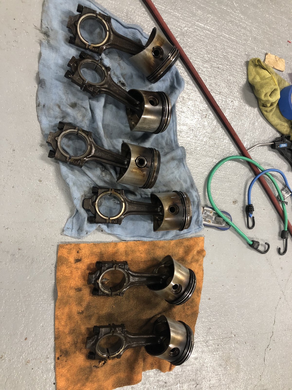

I also didn't want to pull my engine and pay big bucks for the total rebuild on a low mileage engine so I challenged myself to do this engine-in-situ after reading the blue book on how to replace a piston, I thought what the heck I'll do all 6 :cool: . Off everything came to get to the pistons, while doing this I took time to refresh many things along the way (a list later). Existing pistons out:
I am very glad I did this because one of my pistons was missing a gudgeon circlip (the pin easily slid out from one side) and #6 cylinder rod cap bolts had lost their torque and were not very tight! Yikes. Onward...

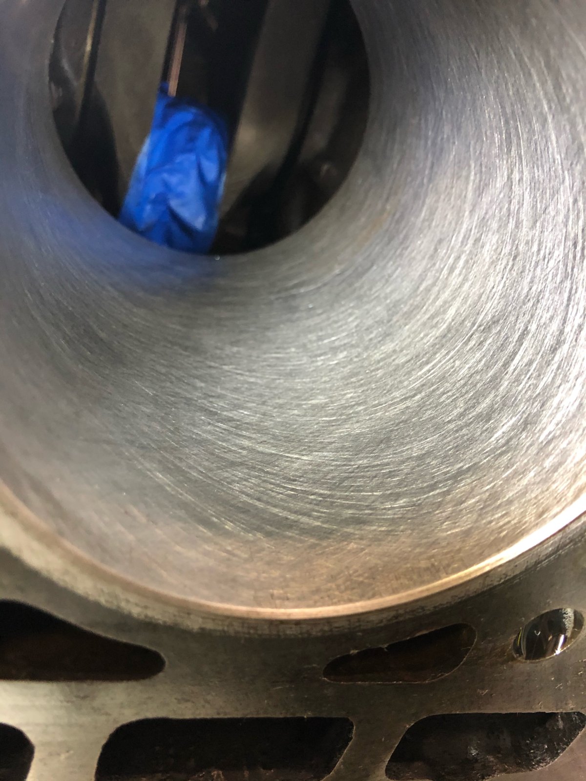

@stphers took me under his wing and gave me invaluable advice and encouragement along the way, thanks RIck! He told me how to hone the bores and get the cross-hatch:

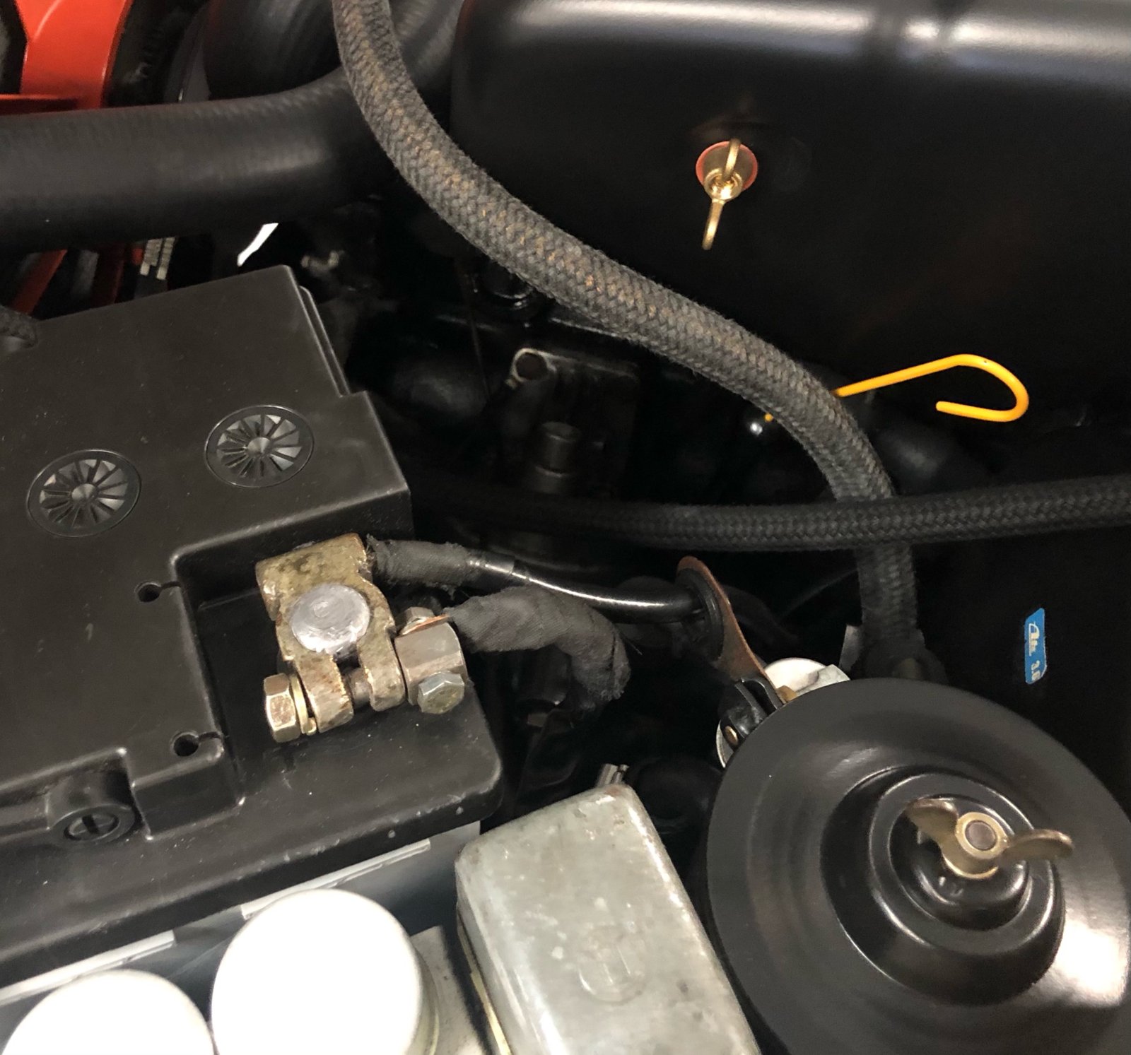

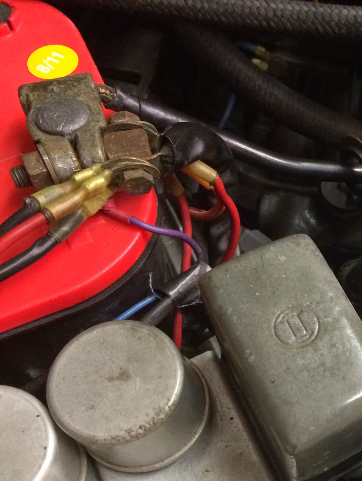

And polish the crank with 600 wet sand and a shoelace from below. While the pistons were at the shop getting my connecting rods put on and balanced, I did major detailing and rewiring. I had no less than 7 connections to the + side of the battery for accesories which has bothered me for years, looks like crap all cluttered. Before:

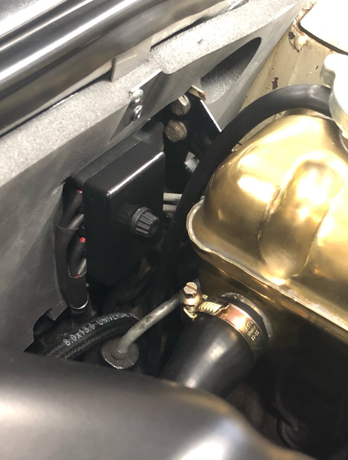

I installed a vintage style fuse box on the firewall (with the same torpedo fuses as under the dash) to fuse the relays of the horn, high & low beams, and window relays/stereo amp. I realized while doing this that not only is the low beam circuit not relayed (I changed that years ago), but neither high or low beams are fused. The horn has a fuse but it's not the relay that is fused. I also cleaned up my driving light circuit and a/c fan relay connections and wiring etc under the headlight acess panel. Here's the fuse box with beefy wiring, it's fed off the starter post and big cable from the battery:
And the result of the rewire is I now just have the original cable to the battery with no janky clutter (hmmm I need to clean up that tape):

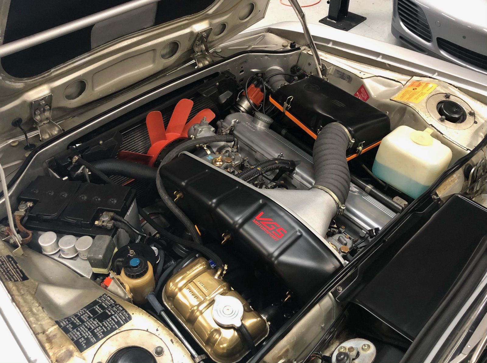

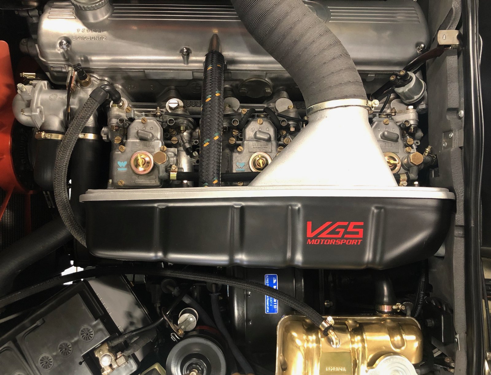

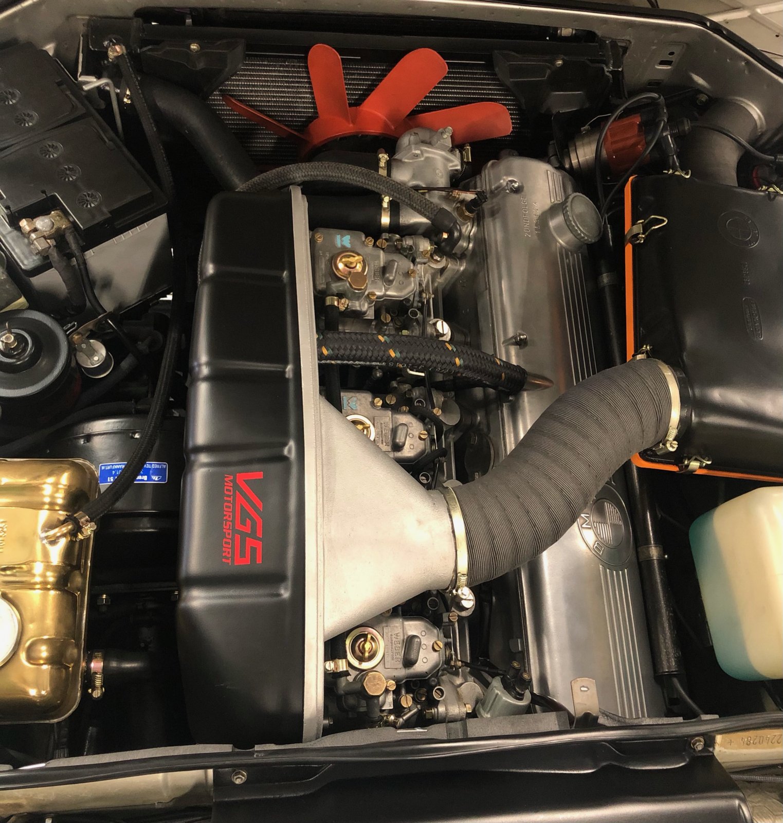

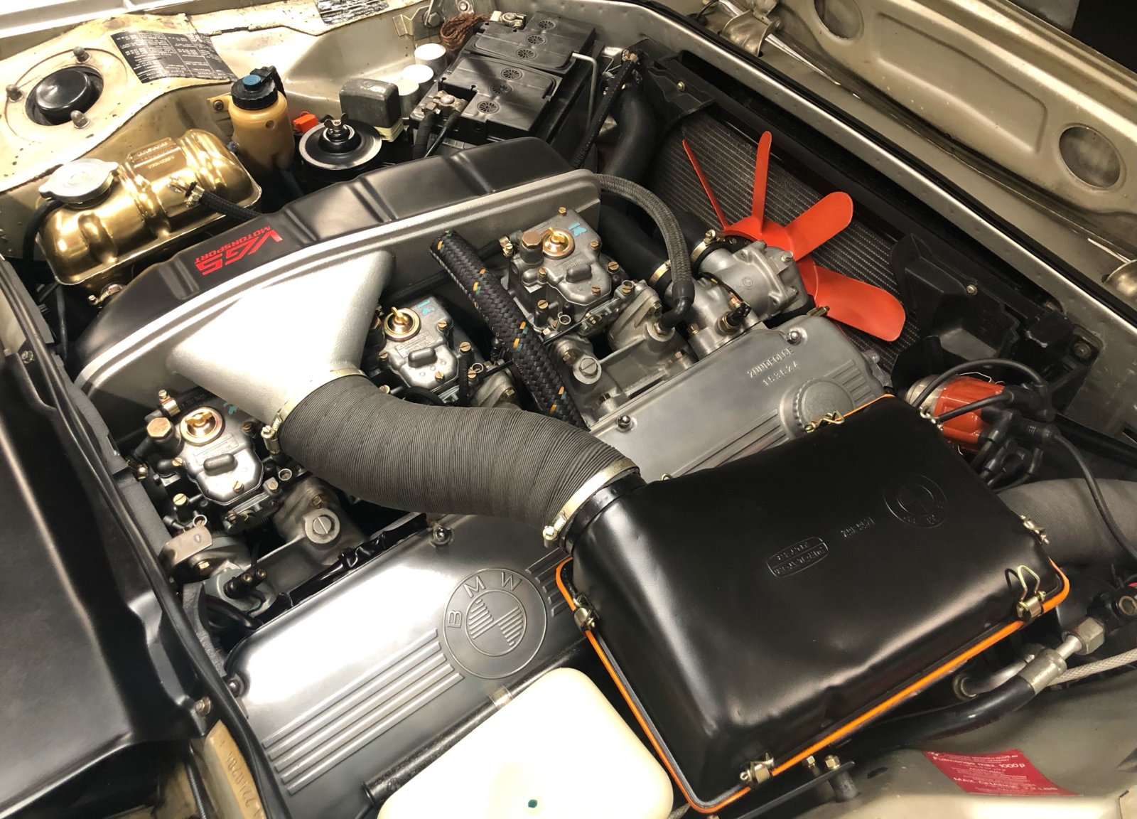

Finally, I had a stencil of the VGS logo custom made for the airbox, and here are the resulting bling shots:
This is the nicest it's going to look in my lifetime because from here on out I am going to drive the hell out of this car! I am tired of working on it, but this was a lot fun and satisfying to do this project, I learned a lot with the help of fellow forum members. It's ready for a long road trip at a high rate of speed!
