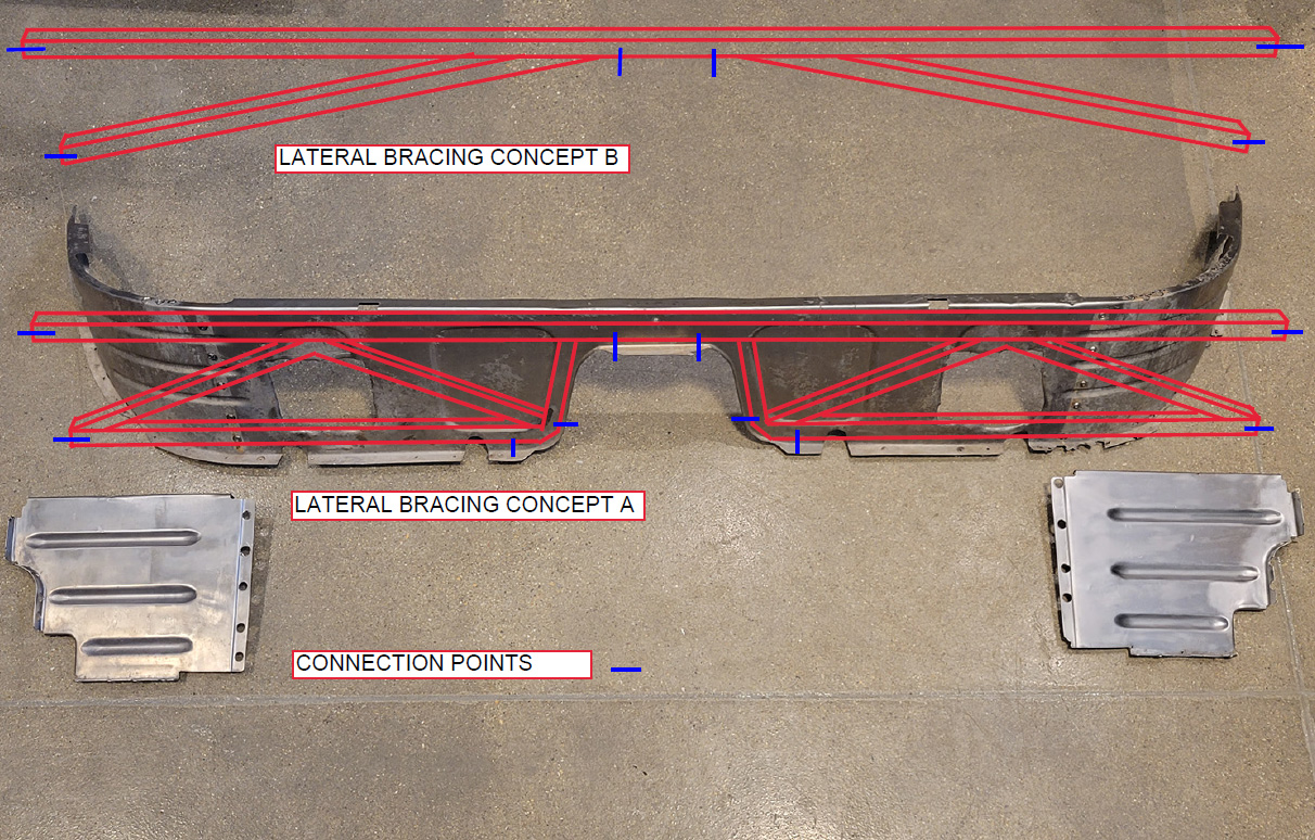

Almost forgot another topic. I also removed the rear seat riser and left side gusset. This will make patching the speaker holes and any corrosion patches much easier and better. This assembly of three pieces (riser and gussets on each side) appear to provide some bracing/stability to the inner sill and B-pillar. But the sheet metal is thin and is not attached very robustly. In fact, there are two factory mig welds at the top of the tunnel to the riser, and one of mine had cracked, the other showed stress.
I don't want to add much weight, but I wonder if making a tube brace of some sort would add noticeable stiffness to the chassis. This would be entirely behind the sheet metal pieces and would not be visible in the car (unless you removed the rear seat). I am showing two versions in the following sketch. A third would be to tie this assembly back to the chassis points. Thoughts?

Personally I wouldn’t add bracing, but as you have to repair all the pieces anyway is there any mileage in considering remaking everything in thicker gauge steel and welding it in more thoroughly?

I thought about a similar thing while working on it. Didn't make any mods there is myself, but I seriously considered a horizontal brace, tucked under the top edge. I've seen it in another members car here on the forum btw.
Wrt forces in those area's, 2 things that I have noticed in various e9's:
I have seen some cars with cracks in the floor at the front edge of the diff mount reinforcement plate under the car. It is basically where the drive shaft tunnel ends when looking front to back.
Secondly you mention that one of the mig welds failed. I can only think of a mechanism for that failure when one rear wheel pushes a corner up. If then the sill bends up ever so slightly ( remember it will always bend a bit, we just may not see it happening), the seat riser and its 2 migs welds will shift left to right and back relative to the floor. To counter act this, you'd need a triangle in the vertical field from the rear wheel arch to ( roughly) the failed mig point. But that is cutting it right through your seat buckets. Limiting that left-right shift therefore only seems doable by making a horizontal connection from the failed mig point on top of the tunnel with the rear chassis corners, the large pins; is that low enough to clear the underside of the seat buckets? Your concept B will also help to limit this left-right movement.
On the other hand, the failed diff mounts in that area are probably due to rotation forces of the differential. That piece of floor would also benefit from some reinforcement, especially if you drive the car spirited. Annoyingly, again here going vertical is what you need, but the seat buckets are again in the way; I think there is little or no space to be found to fit a tube from that front end point of the diff reinforcement plate to the curved section making the rear wheel arches, roughly where the upper belt mount points are.
Could you tie them in to the sill at the b-pillar; another triangle roughly in the horizontal plane? Basically, taking option B, but adding a diagonal from the failed mig po oint to the chassis points (thick vertical pin )?
Hope my words help a bit. Currently skiing, so no access to easy sketching tools on my phone....
I think this is a solid approach - the engineers must have crunched some numbers back then. These pieces are probably more complex than I can handle (in a reasonable amount of time). But I can look for areas to reinforce the sheet metal.

I am half following. I probably need to look at the car and read your words again. And I should also pull my rear seats down from the shelf to make sure I don't create a conflict. I do like the idea of getting some diagonal reinforcement between these critical force points.
