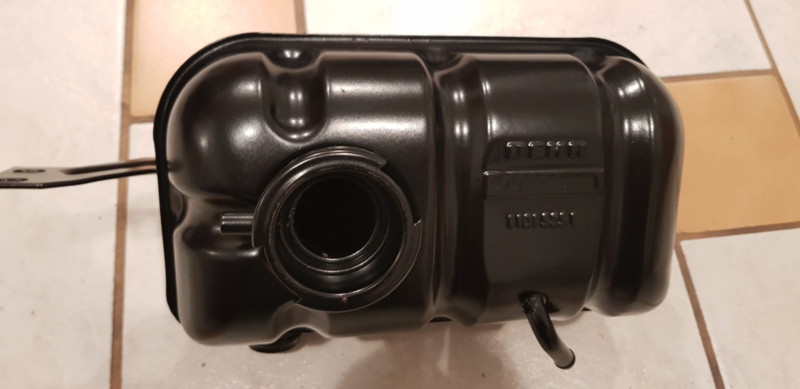

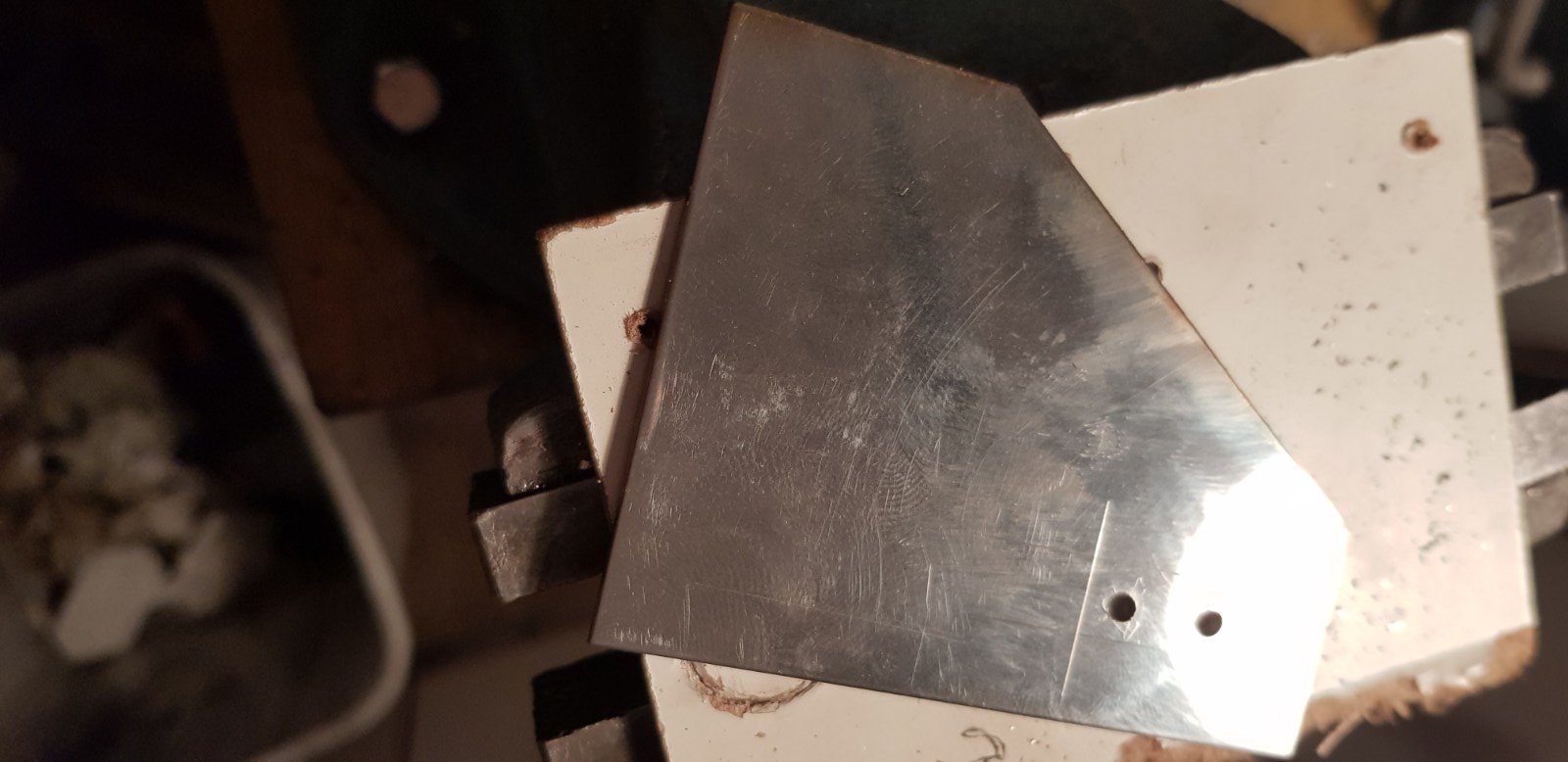

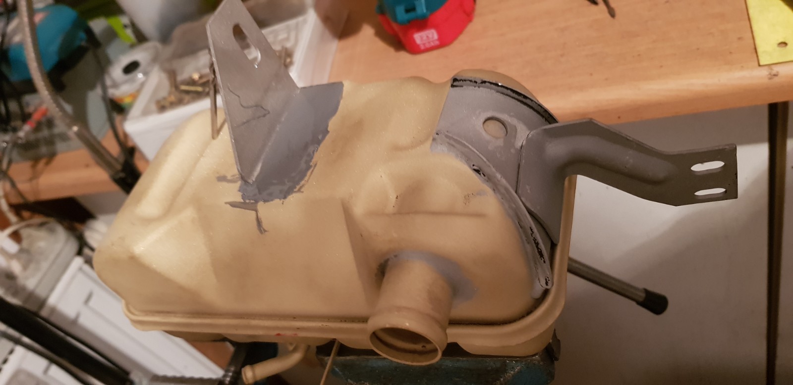

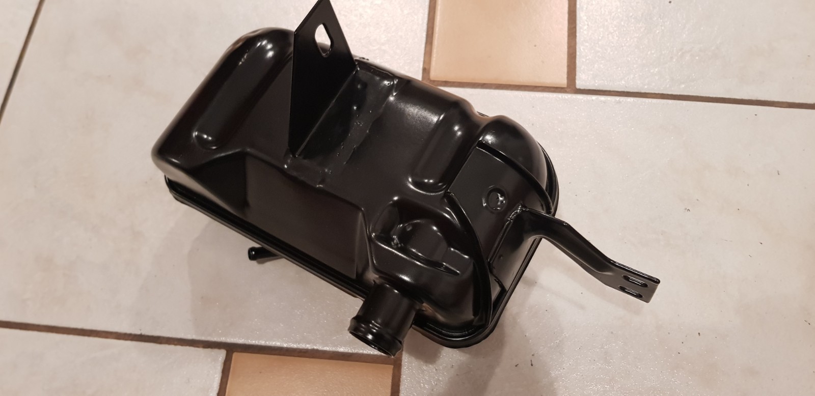

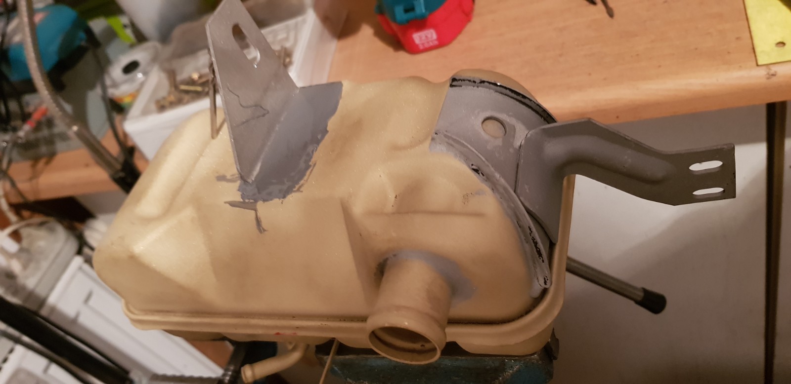

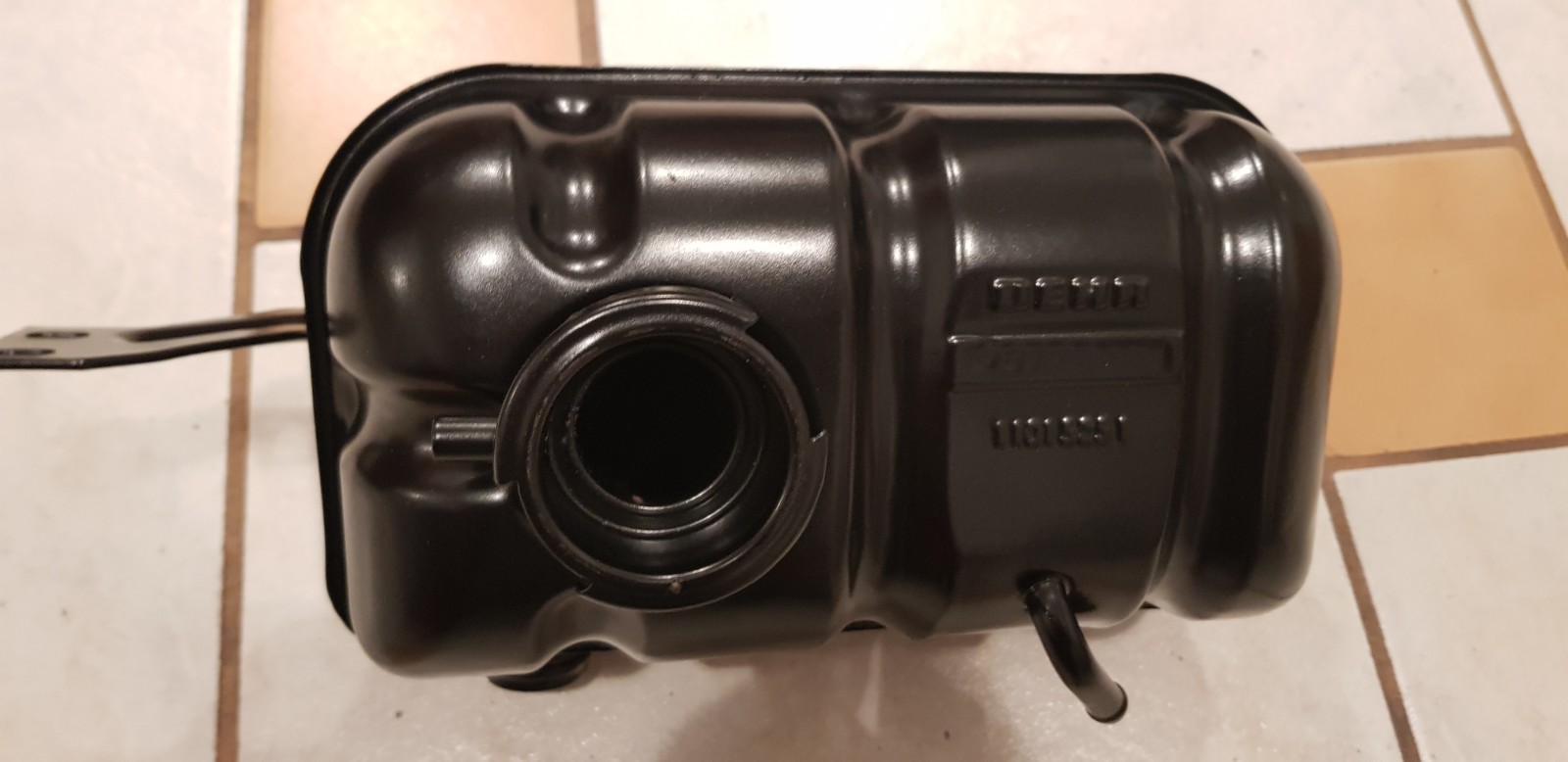

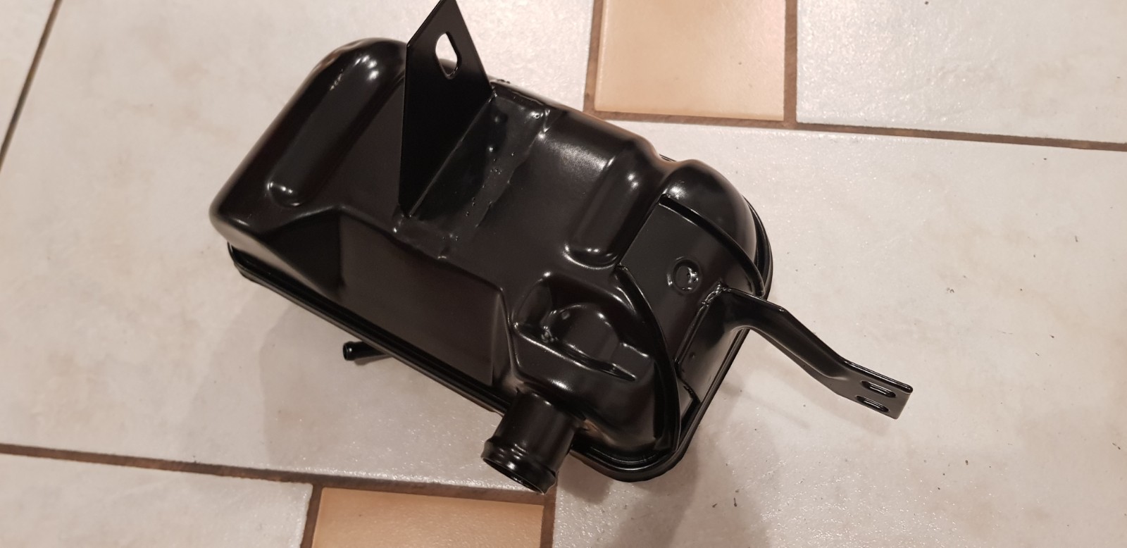

This week finally end up restoring my brass coolant tank.
Lower bracket was missing, so new one was made from stainless steel, glued on with high tempertature resistant adhesive for metal & painted with low temperature powder paint (backed in ca. 130-140C), so was no solder melting.

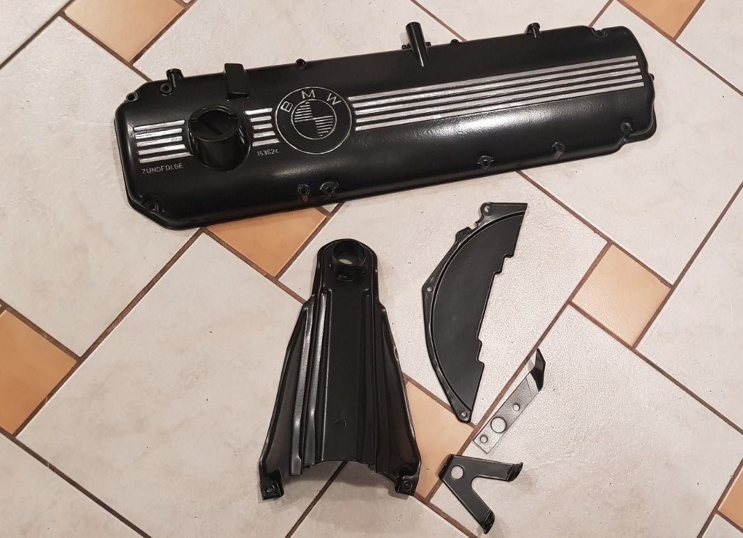

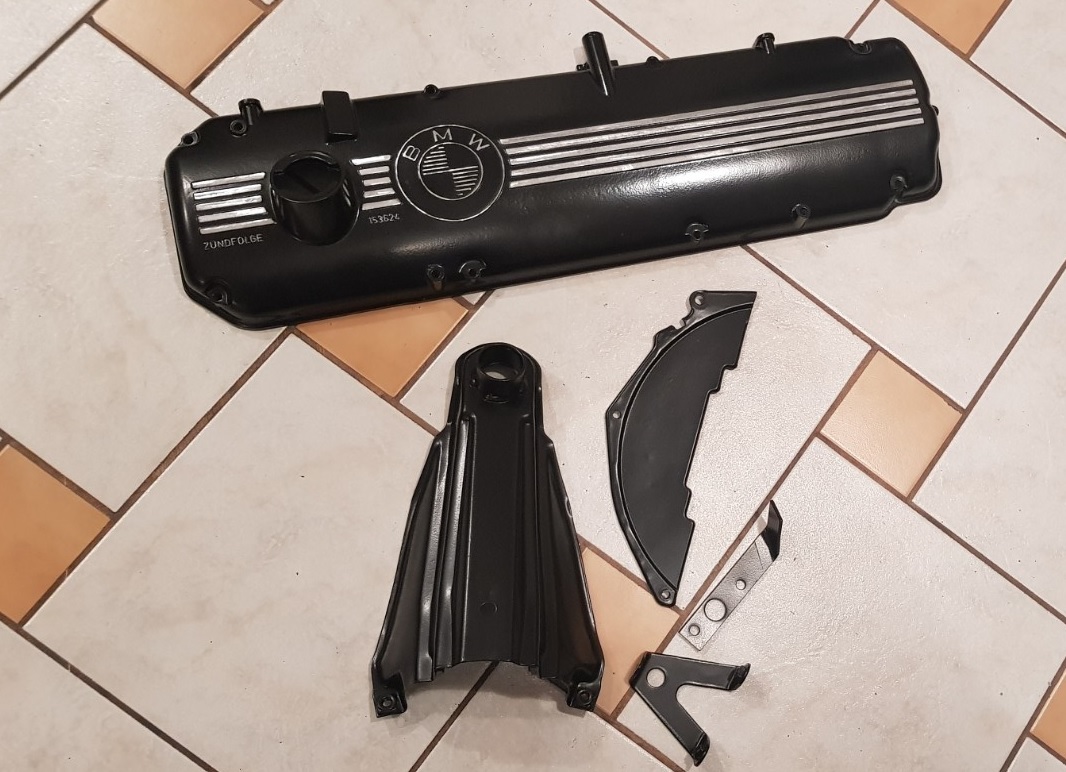

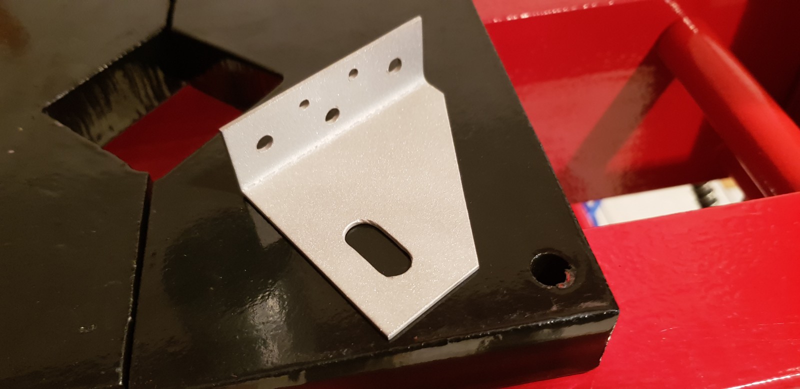

Some little additional powder coating
View attachment 56839 View attachment 56840 View attachment 56841 View attachment 56842 View attachment 56843

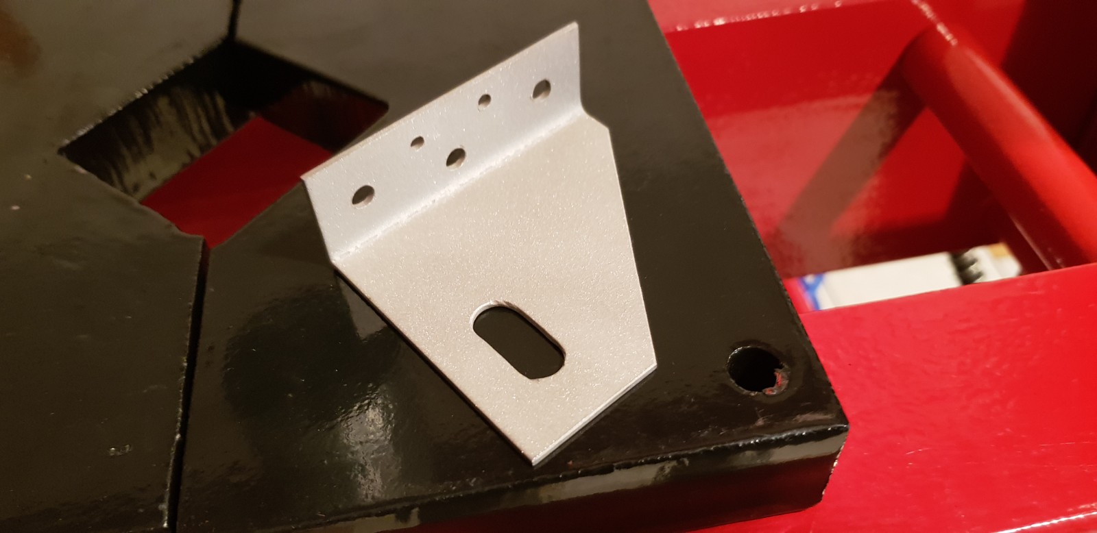

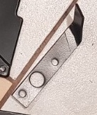

The straight one is throttle stop.
I recognize the throttle stop. I sold mine knowing that I had no other. Fortunately miklos and coupe king make reproductions
Last but not least, I was referring to this guy. I presume the big center hole is important and the two other holes are for bolts.
LOL, it’s a throttle stop. Hard to see here but it mounts vertically. I’ve never seen the V shaped piece.
