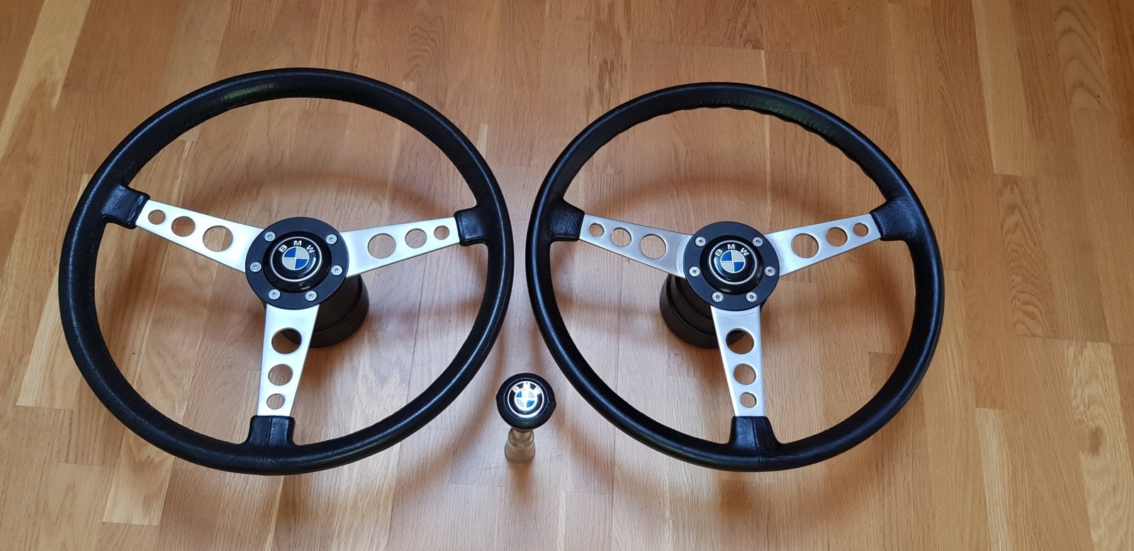

2x 38cm
Beautiful wheels Wladek.
They also clearly show the different tab shapes, square vs V shaped. I’m hesitant to say that one is Bmw and the other is VW. Seems the V style tabs have more of a texture on the wrap than the square style. Petri fanaticism I guess :)
You know, I was wondering about the different tab shapes. Wasn't sure if that was the difference between leather wrapped and foam, or some other distinction. Do you have a favorite? Or should I ask, which one is the original BMW version?
Yes, I realize that I am getting myself into troubled waters here... The more I know, the more I want. :eek:
Yes, you are right Keshav - V shaped have more texture on the wrap, square is almost smooth.
There was a big thread here on forum, where almost everyone took part & if i remember correctly it was agreed conclusion that both (square & V shape) where originally used in BMW's
As far as i know - there are next tabs & grips on BMW 38 Petri's:
1. Thick square + thick soft foam grip - standard BMW
2. V shape + thin/medium hard foam grip - standard BMW
3. V shape + thick soft foam grip with protruding stitching - standard BMW
4. Medium square + medium hard foam + leather wrapped grip - CSL BMW
5. Thick square + thick soft foam grip with protruding stitching - standard BMW
On the photo's above are #1 & #2
