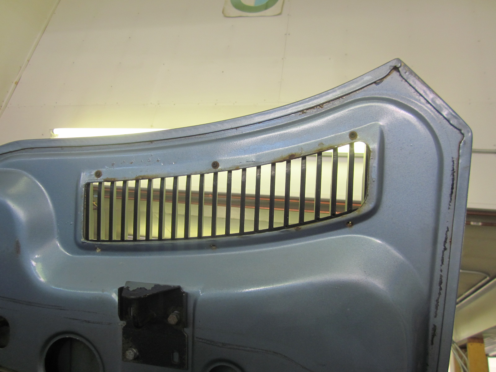

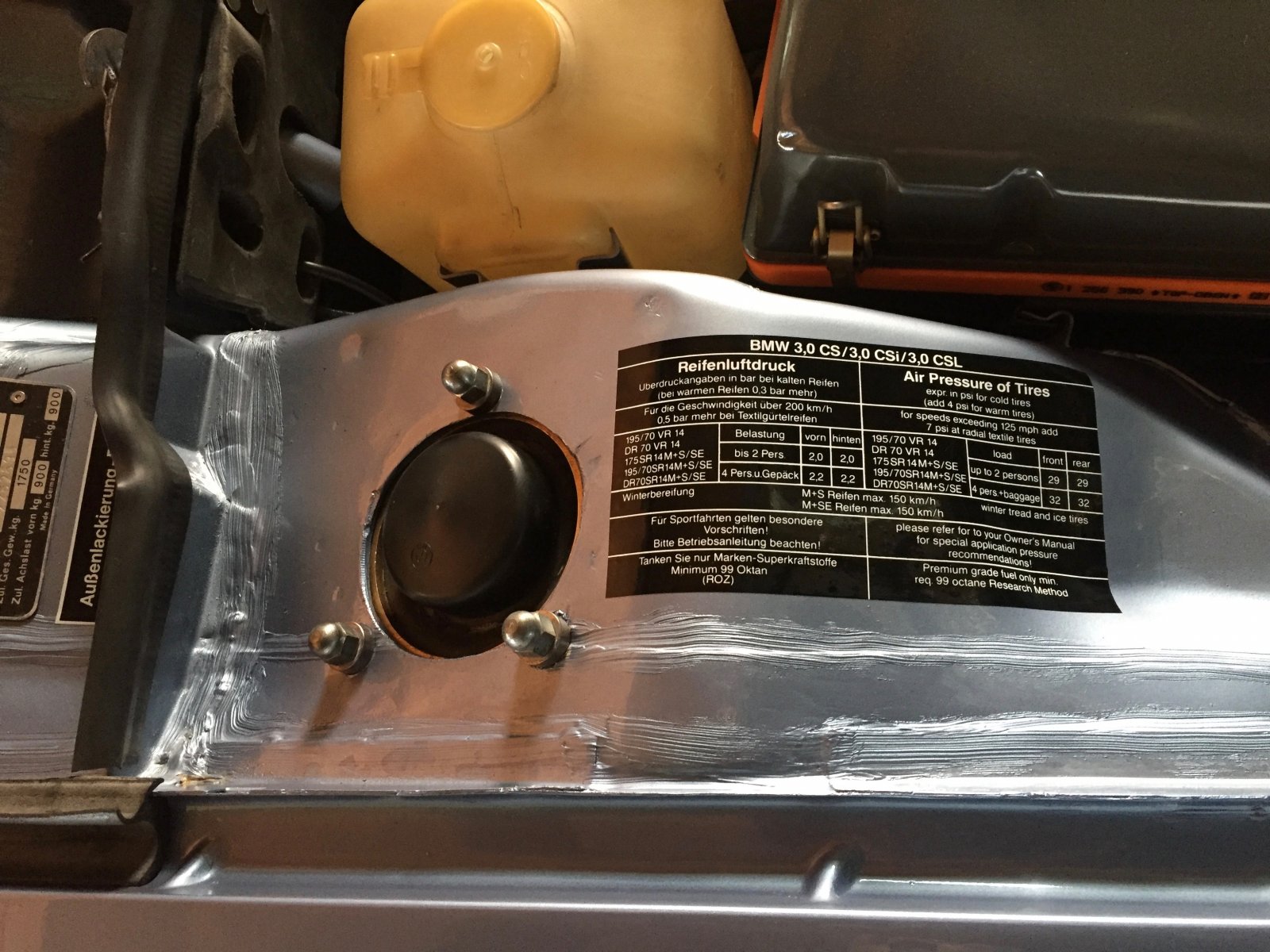

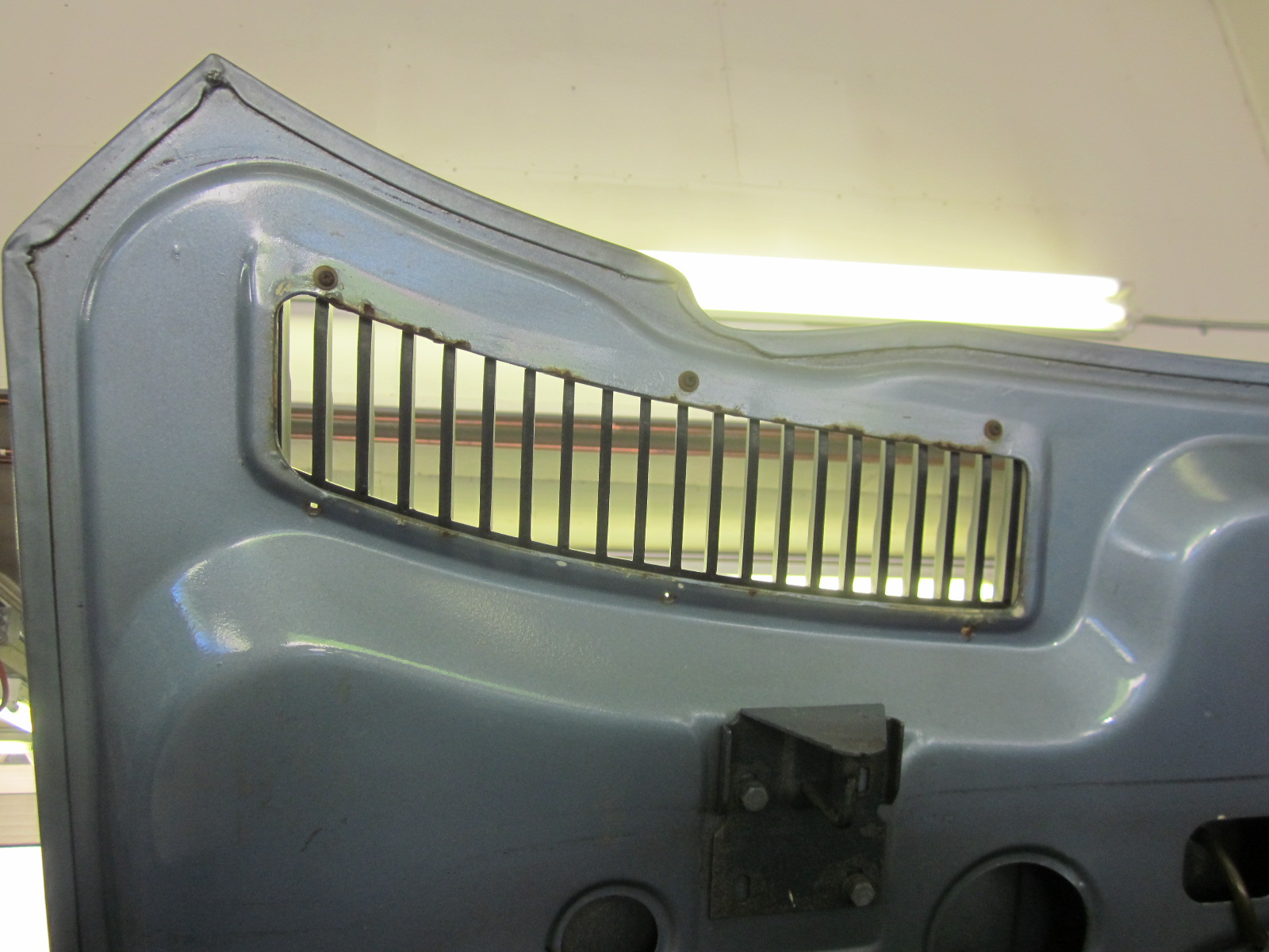

went to visit my painter on Friday ... to prod him along. i was happy (read ecstatic) to see that work was finally progressing on my coupe. they chemically stripped most of the engine compartment and the inside of the doors. they are going to finish the engine compartment with bead blasting. the hood and trunk have already been painted on both sides - he will do the final coats when he paints the car. they were in storage so it was too dark to get a finished pic ... but i could tell that they looked quite good.
my painter asked a good question - seam sealer. anybody have any good pictures of how BMW originally finished the undersides of the hood / trunk edges with seam sealer. i would appreciate any detail photos.

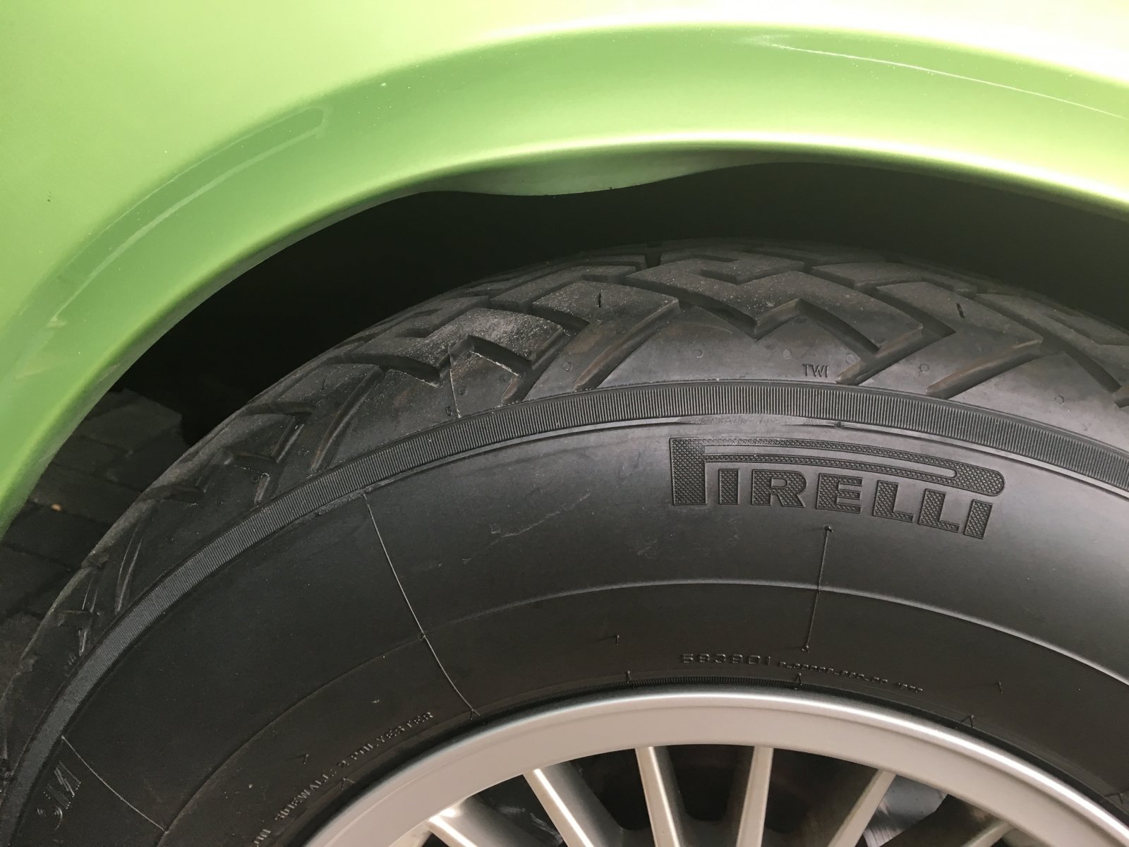

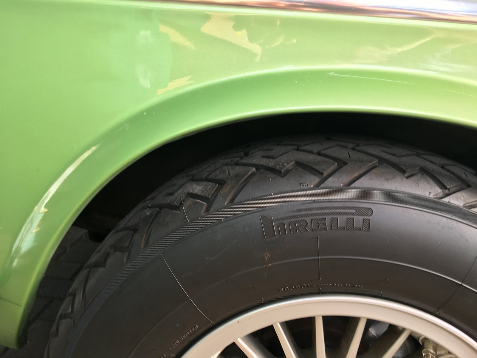

Ouch... Time for negative camber plates, or do you already have them?
No camber plates. It actually happened last month up at O’Fest and I am just getting around to fixing it. At one of events they had us park in a field that was uneven with ditches. I do not plan on doing anymore off-roading!
i can send you my fender rolling device. you bolt it onto the axle and slowly move it back and forth and will slowly move your fender lip back to a good position ... whether you want to roll them all the way or not
And best to use a heat gun to avoid cracking the paint.
rsporsche,
I know that there is no seam sealer on the hood or trunk lid but I would take a syringe and squeeze a little bit in the seams that are folded over just as another precaution for rust developing down the road. It has to be very little and just enough to seal it, wipe it down with a rag after putting it on so you could hardly see it but it is sealed I am nuts about making sure that I use every precaution to stop rust
Thanks, Rick
rsporsche,
Thanks, Rick
On the other hand, water might get trapped if you seam seal the hood and trunk, resulting in even more rust. I don't have a definitive answer to what's better in this case, but it's something to think about since water/moisture can get to the seam from the other side.
Shoot a water-displacing oil into the seams. I use Owaldöl in CH... Zinz... help me out.. What is the name of the spray oil you treat your aluminum surfaces with in the US?

Thanks guys. The broom handle worked with incremental and progressive leveraging against the tire to get the lip back to the "L" shape profile (a kinder gentler version of a NASCAR baseball bat tire rub pit stop). As long as I stay on the roads I should be OK without a full front fender roll.
