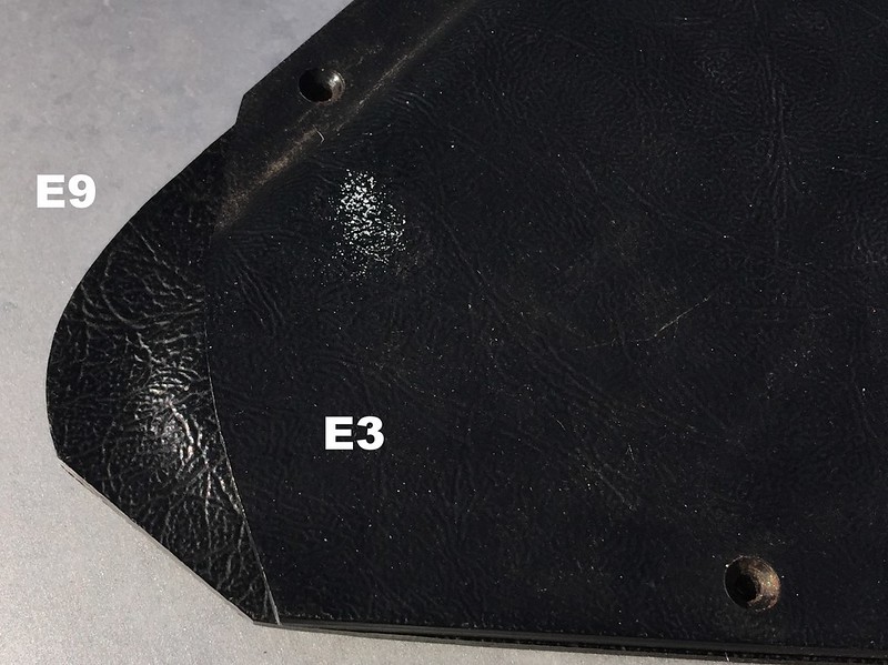

Settling any questions on the difference between E3 and E9 AC Vents. They are the exact same vents with the E3 cut slightly shorter. As other's have observed, the pattern embossed on the E3 vents is slightly less noticeable, but they aren't perfectly smooth.

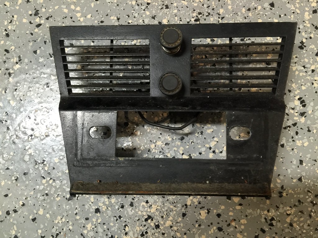

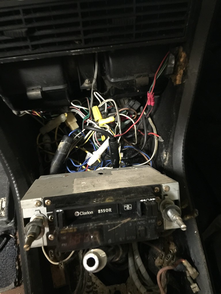

I started to tear into the center console. Nothing noteworthy about the removal yet. The vent console is a bit tricky with the air blend cables still attached. I decided to call it a night before pulling the glove box to access disconnect the cables. The console sides are now stashed away with the gear surround and AC face plate.
The AC plate is in decent condition. Notice that the radio post holes are oval, not round. This one has been massaged a bit, but at least it wasn't hacked up to accommodate a single DIN radio.

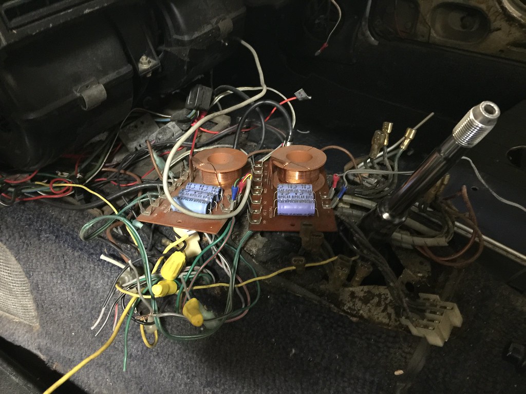

I just can't get enough of 80's stereo installs. My favorite was the creative use of telephone cord.

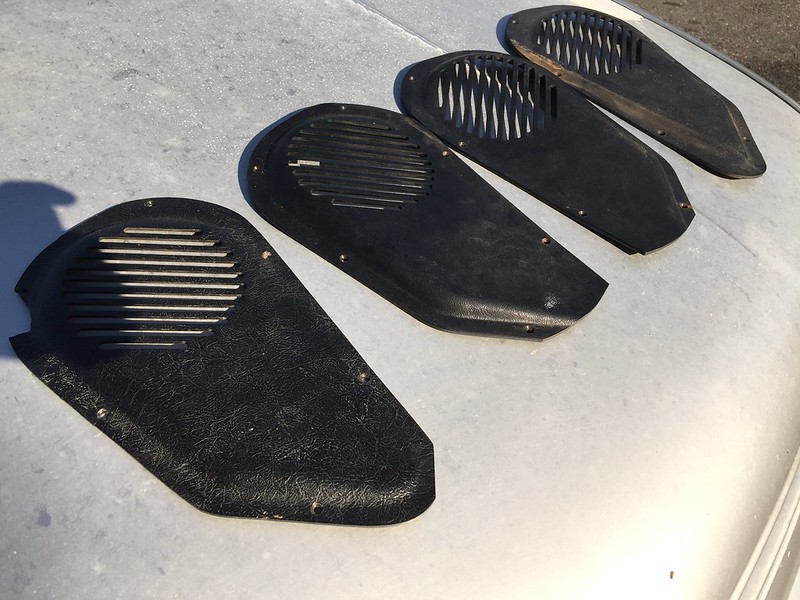

Of the four side grilles shown, the one on left has the small cut at the tip, this is e9. The one on far right without the cut matches our 1970 2800 sedan. The two in the middle are from a later e3 I presume, I don't know why they needed to be shorter, the console is taller and there appears to be more room towards the firewall.
Thanks Chris! The one on the far right has a grain pattern similar to the e9. So it looks like there are three types total. The one on the far left is from my CSI, matching your observation. The one on the far right is from my buddy. My version of the one on the far right (removed from my car this morning) has the small cut. They are all the same, just cut differently. The late model vents have a less defined pattern on the face.

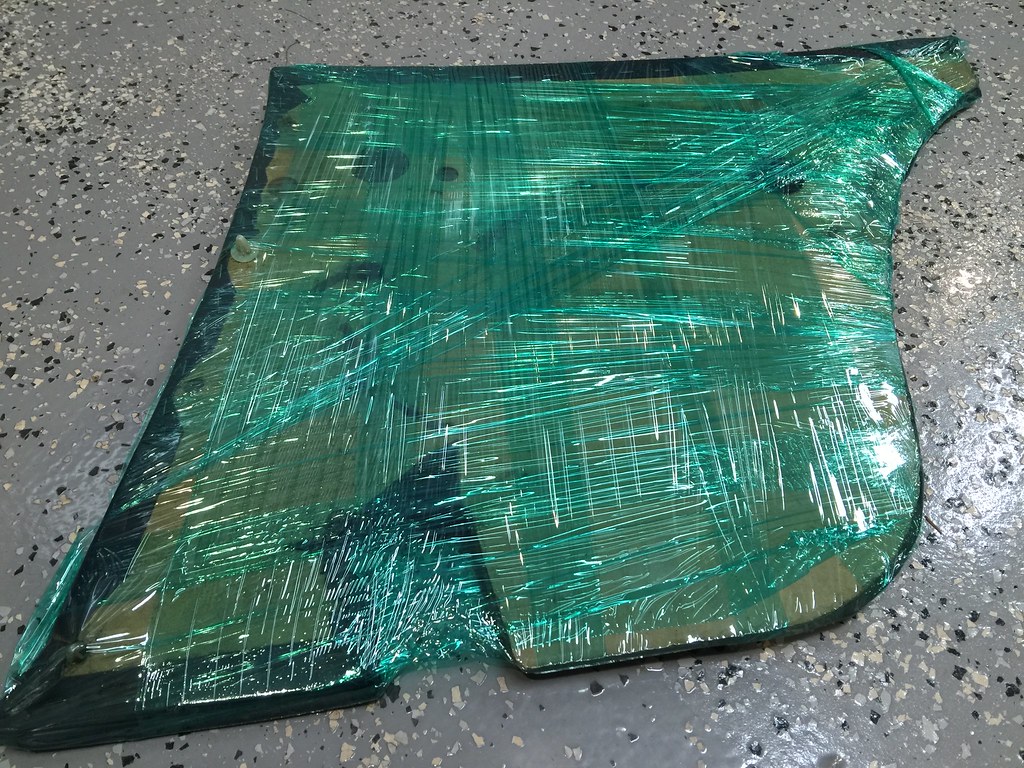

Sold the door panels in under 8 hours, for $107 shipped. I need to get a move on. My collection of boxes is starting to out pace my parts sales. I blame the convenience of Purchasing diapers via Amazon. :)

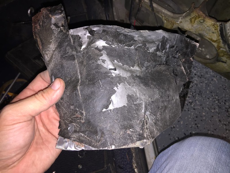

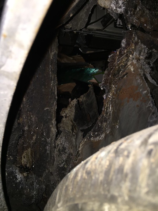

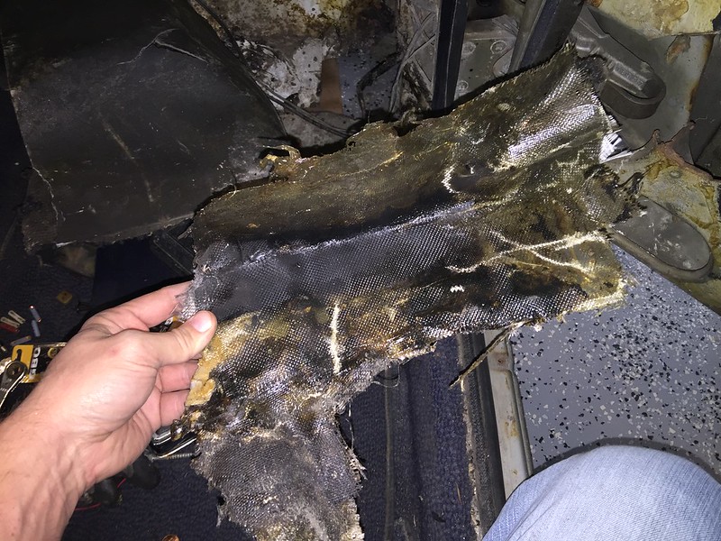

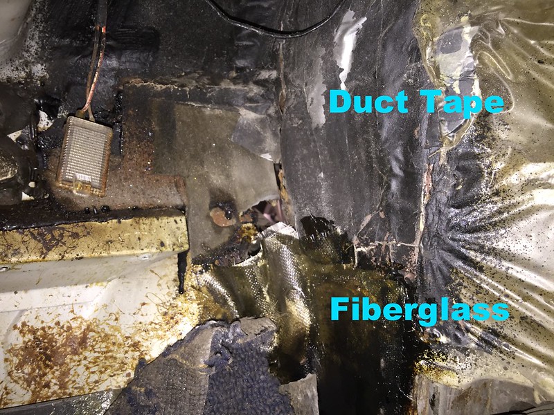

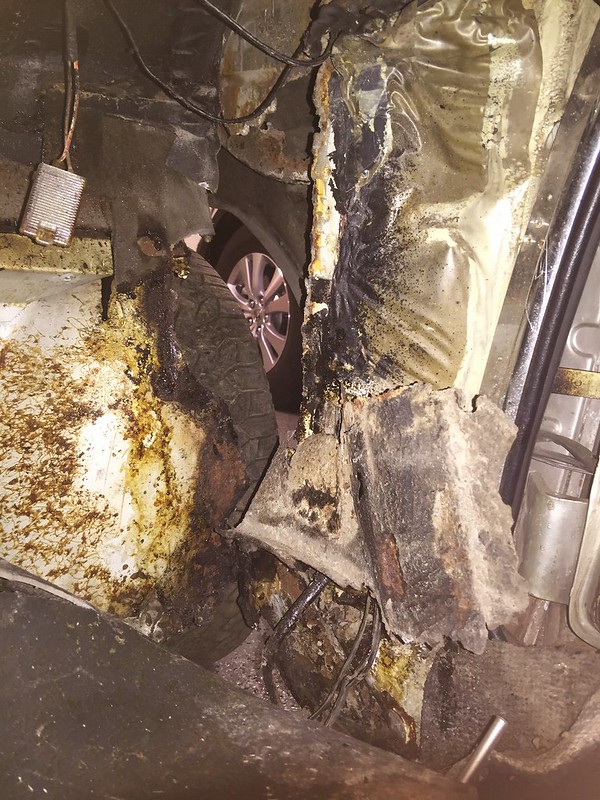

I made this statement just the other day, and my deconstruction work this evening only reinforces this observation. Case in point, the dashboard wood in my target coupe is completely shot, no doubt due to water infiltration. The area under the glove box looks pretty decent though. Next we have the CSI, with a perfect dash and wood that only requires a light buff and polish. With that said, Brace yourselves!.
What I found is a mixture of tar covered duct tape and fiberglass. Someone without any metal fabrication skills desperately wanted to keep this car on the road.
Fiberglass + Duct Tape + Tar = Structural Integrity!
Duct Tape:
Fiberglass
Take a moment to review. What do you see? E9 tire, Honda wheel, garage floor, fender lip, glove box light, upper fender box absent
View from the outside:
Didn't Fiberglass and duct tape lead the way to modern day carbon fiber:grin: you may have something for the smithsonian.
Exactly, much like the kid who accidently dropped his chocolate bar in his lunch mate's peanut butter, it was the inadvertent mixture of fiberglass and duct tape that led to modern day composites. I've been told that the Boeing 787 uses a similar technology.
