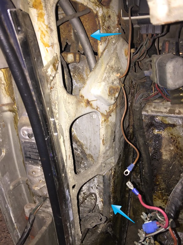

You happen to have a picture(s) of the sunroof drains? Does one (on each side) go down the a-pillar and another down the c-pillar? Curious where they are and where they end.
I haven't snapped any pics. They end in a giant rusty hole int he rocker panel :D
Seriously though, you were asking about the window grommet not long ago. They travel through the void right behind that grommet. Inside there you will find a harness connection for the power windows, and an impossibly difficult to unscrew window ground wire (I think they built the car around this ground wire). Without looking, I assume that it drops right into the rocker, which has about a 25mm drain rectangle thingy nearby. I'll stick my phone in there and snap a pic. I haven't looked at the rear exist as of yet.
In the rear they simply drain into the rear window cavity, there are slots in the bottom to drain outside. These get plugged and the rockers soon turn to rust. Some use a pipe and tap it into the rear wheel well instead.

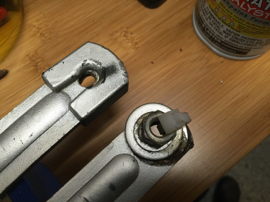

At this point I no longer needed to unscrew the AC soft lines. They aren't very flexible and pose a shipping problem due to length. I wanted to get them decoupled from the hard lines and the condenser.

Anyway, the fallback plan that provided significantly more leverage is my mobile vise. It mounts to a 2" receiver hitch. The vise and the cheater bar with a bit of PB Blaster made short work of the couplings. I didn't need to use heat.
Some tools of the trade to get these fittings off. The fisher price circular saw was a game changer according to my 2yo.
This is where the tube runs up front. You can see it bend down into the rocker.
Thanks Markos. And the water just sits in that bottom well? Or does it go all the way through to the outside?

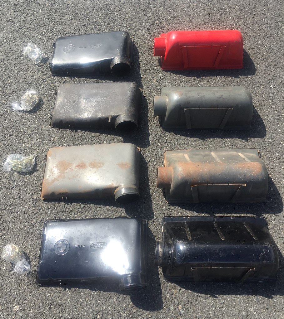

This month is as a lesson in being thoughtful about the part out process. I sold my air box and bracket right out of the gates, but decided that I want one for my DCOE paper weights. Although I don't need it for several years, I setup a private group buy with some locals to obtain a few. I will be sending mine down to Portland for a member to experiment with on his car for a bit.

Look at all those air boxes that aren't for sale! :D
